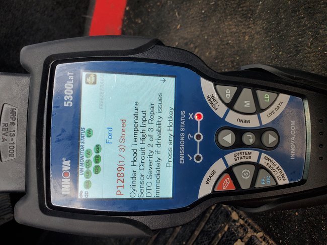

Check engine code 1289
2014 FORD F-150
70,000 MILES • 5.0L • V8 • 2WD • AUTOMATIC
WILLIAM ROBRECHT
Code is the cylinder head temperature sensor circuit high input DTC severity 2 of 3.
From what I have read I need to replace the sensor. I cannot find my sensor. I have looked at numerous videos but being able to see on the back of the engine is near impossible. Is there a DIY video showing exactly how to do it?
Jul 3, 2020 at 11:31 PM

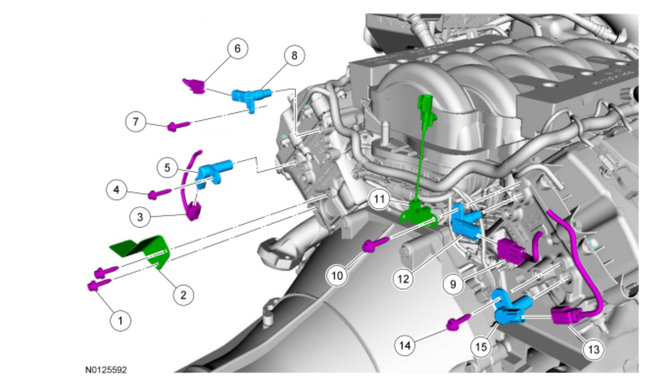

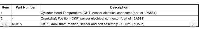

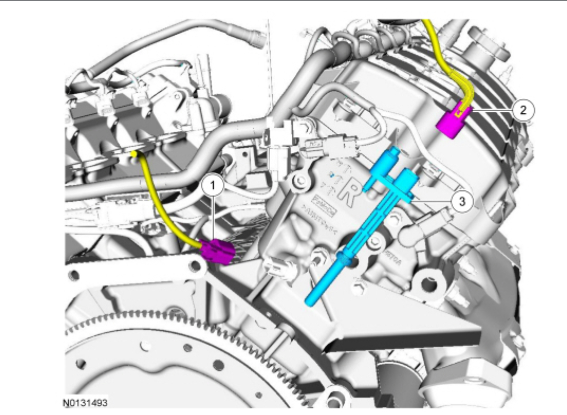

Good afternoon,
The temperature sensor is at the back of the motor on the passenger side. It is a lot of work to get to it.
What is the code that makes you think it needs to be replaced?

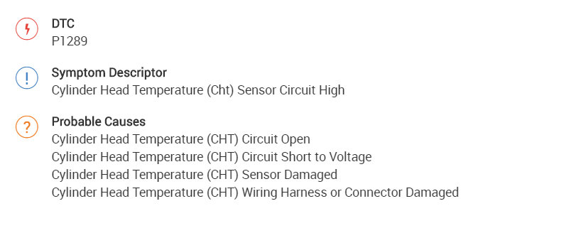

P1289.
Jul 4, 2020 at 4:10 AM

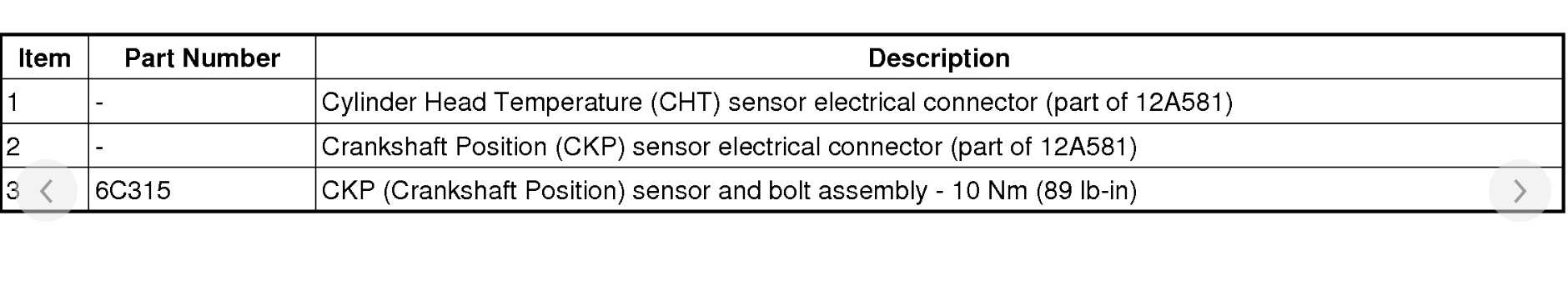

Okay, the easiest way to check this is to remove the connector and test the voltage at the sensor itself.
Put the red lead in one terminal and the black lead in the other. You should have 5 volts.
