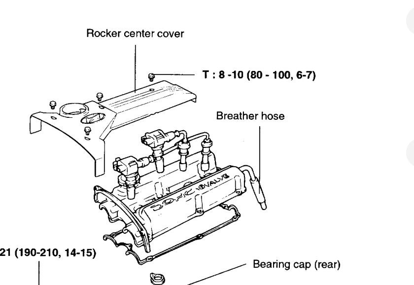

One more question. Can you please help me check the spark plugs? I do not know where they are located on my vehicle.
Monday, August 27th, 2018 AT 7:26 AM
  • 52,797 POSTS
Remove the top rocker cover, two bolts.
Then remove the coils and the plug wires. Then you will have access to the spark plugs.
Monday, August 27th, 2018 AT 8:08 AM
