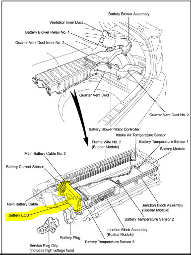

I have these lights on my dash. I read in a forum it may have been the gas cap and I checked. Lights went off and I was able to drive about ten miles no problem. Car sat for six hours came back out and drove thirty feet and the lights came back on. Not sure what the problem might be.

Hello Jim,
To narrow down the issue use scan tool and read the fault codes and report back.
Mar 25, 2019 at 12:00 PM
JIM SHUNK
p0A82 code came up.
Mar 25, 2019 at 12:37 PM
SEVAG P
  • 405 POSTS

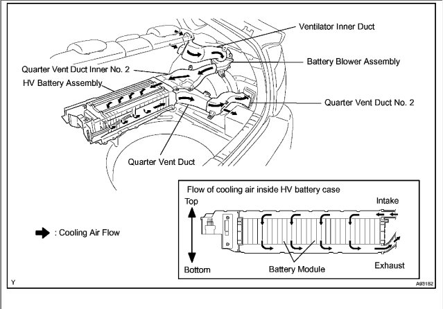

The fault code p0A82 is related to hybrid battery pack cooling fan1.
Difference between estimated battery temperature based on blower fan cooling performance and actual temperature is excessive this faults appear.
System is located inside rear trunk.
Check the ducts and the blower listed below for disconnection and damage ,also check if they have not clogged up with foreign substances.(check fig1)
quarter vent duct.
quarter vent duct 2.
quarter vent duct inner 2
ventilator inner duct.
battery blower assembly.
send feed back we are interested to know what happens.

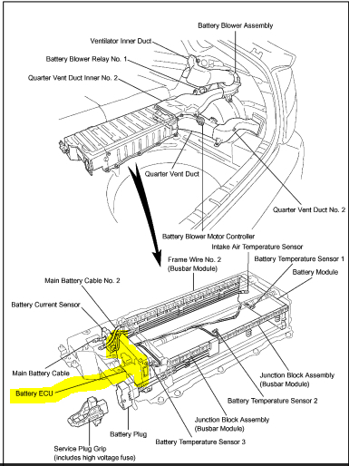

if all the above are in good condition then battery electronic control unit defected.(fig2)
