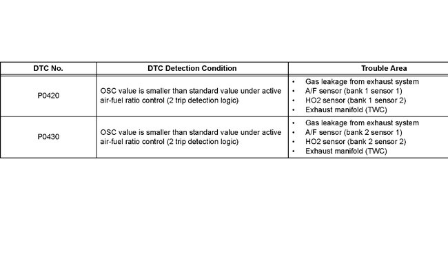

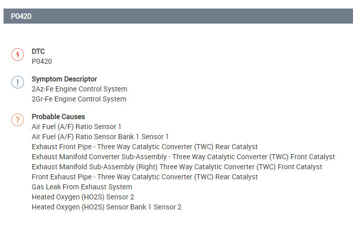

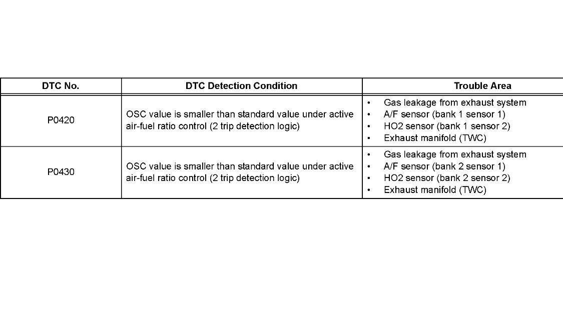

The code P0420 is a Oxygen sensor code for your car.
DTC P0420 Catalyst System Efficiency Below Threshold (Bank 1)
That code should not trigger the VSC error.
https://www.2carpros.com/articles/how-an-oxygen-sensor-works
https://www.2carpros.com/articles/how-to-test-an-oxygen-sensor-02-sensor
Here are some of the reason for that code:
Heated Oxygen (HO2S) Sensor 2
Heated Oxygen (HO2S) Sensor Bank 1 Sensor 2
Exhaust Front Pipe - Three Way Catalytic Converter (TWC) Rear Catalyst
Exhaust Manifold Converter Sub-Assembly - Three Way Catalytic Converter (TWC) Front Catalyst
Exhaust Manifold Sub-Assembly (Right) Three Way Catalytic Converter (TWC) Front Catalyst
Front Exhaust Pipe - Three Way Catalytic Converter (TWC) Rear Catalyst
Gas Leak From Exhaust System

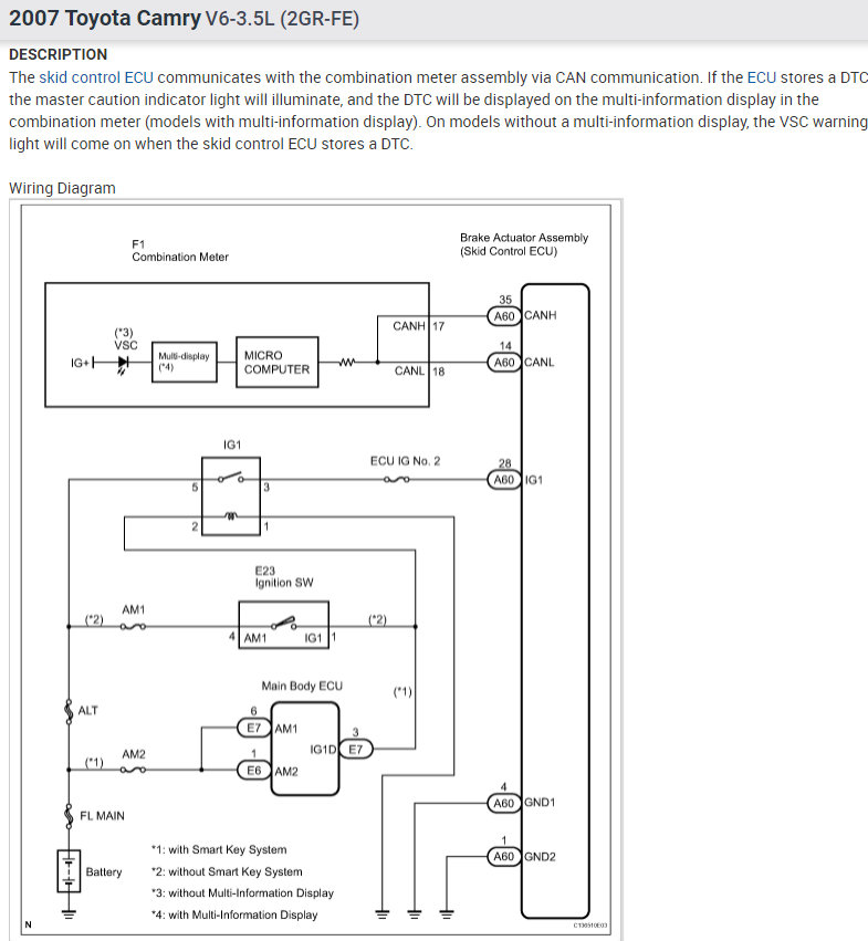

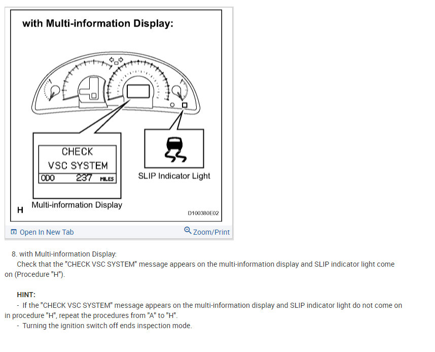

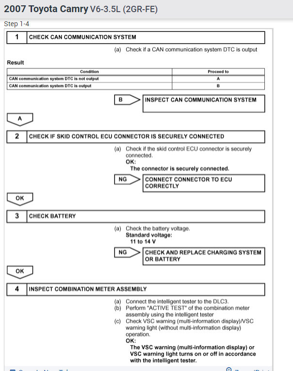

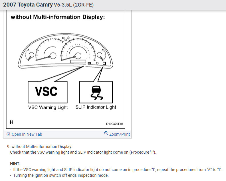

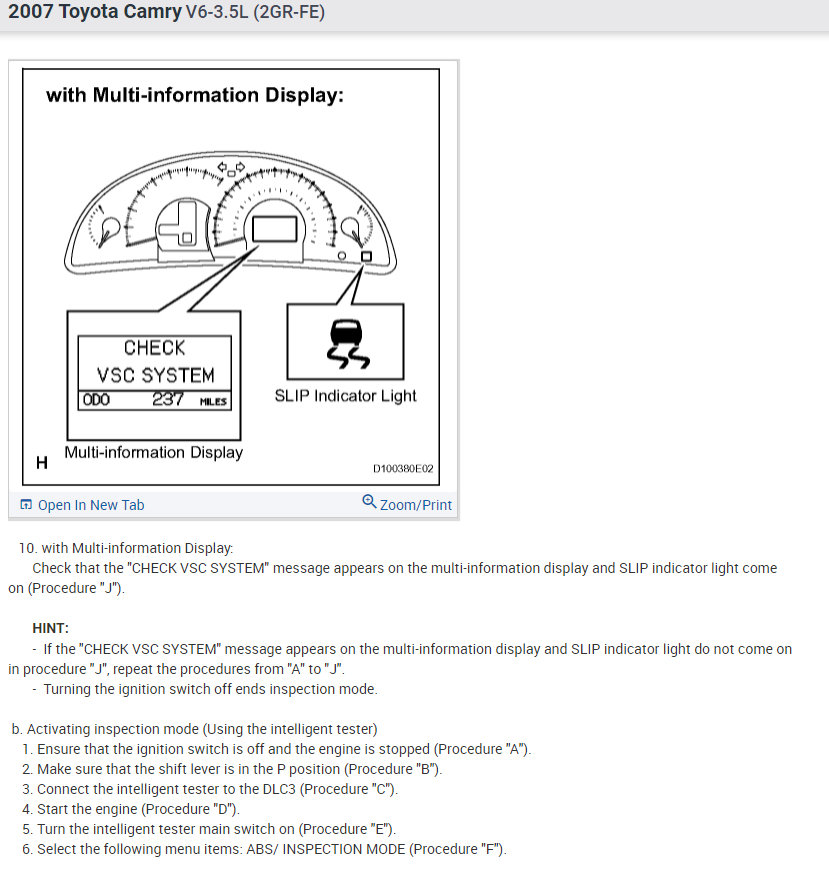

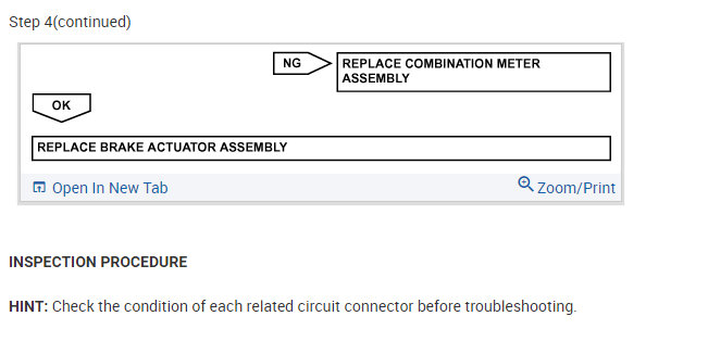

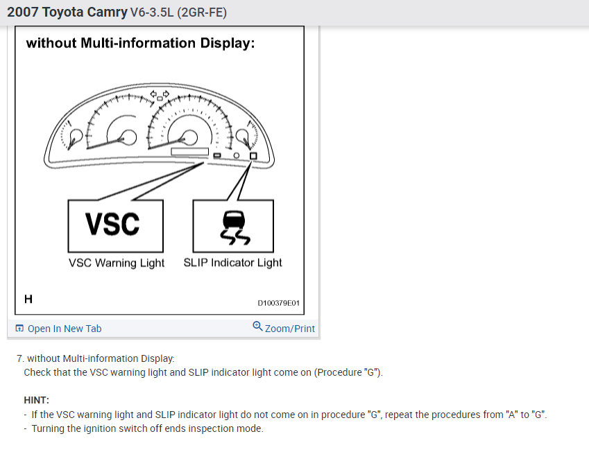

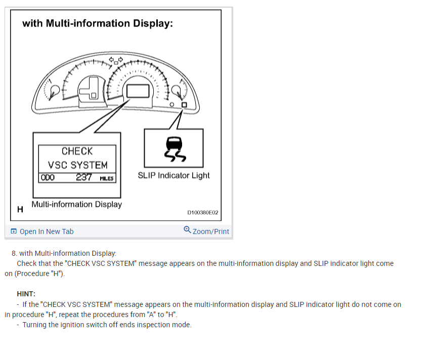

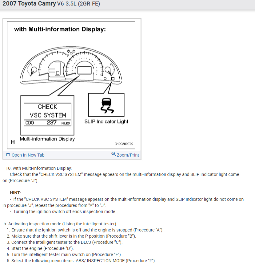

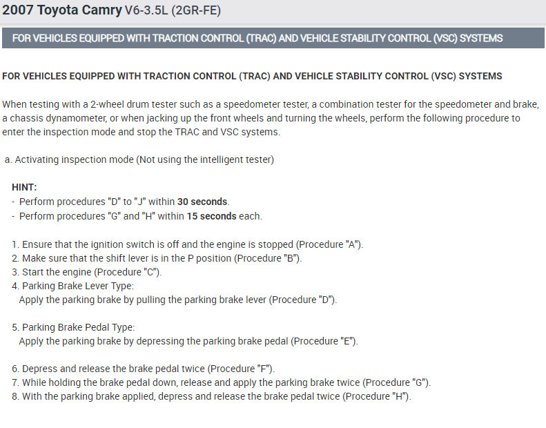

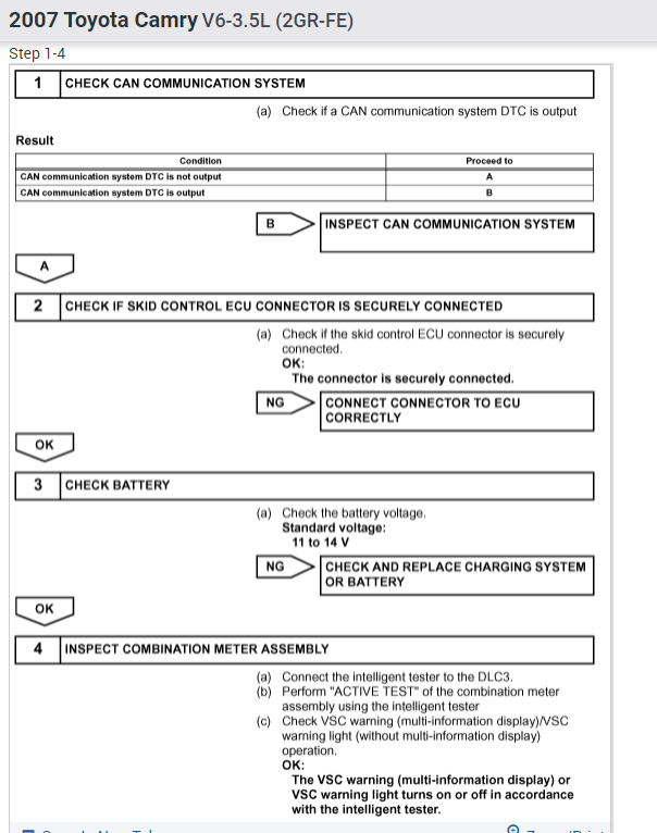

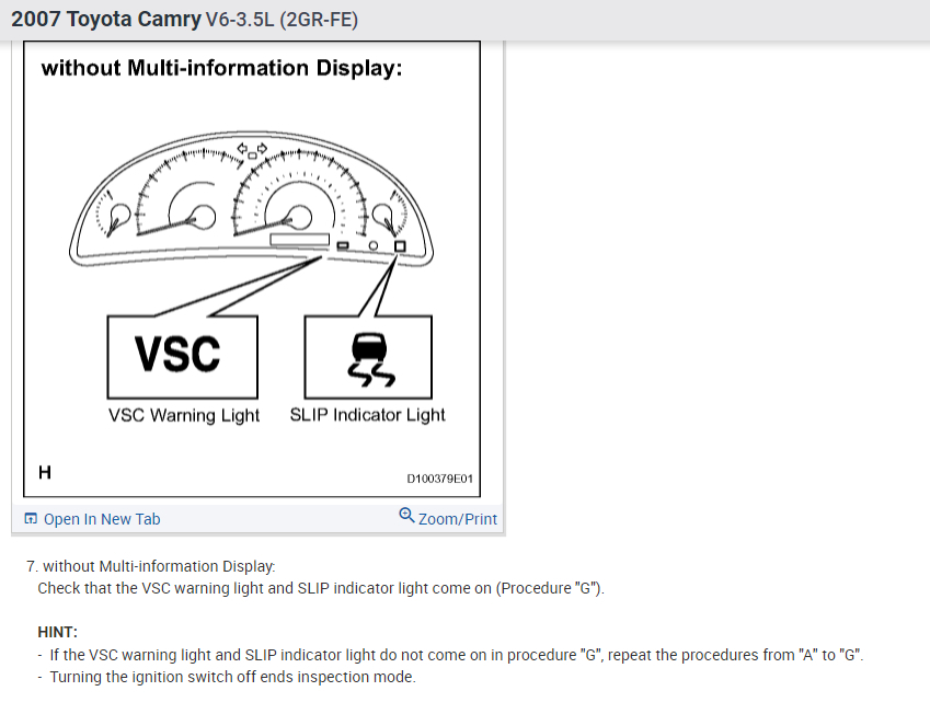

I have attached the basic VSC error diagnostics for your reference.
VSC malfunction what triggered the traction control light.
Please keep in mind if the VSC needs to be programmed it will require special scanner.
