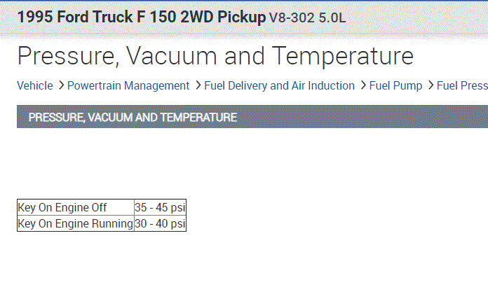

Replaced plugs, wires, cap, rotor, coolant temperature sender, MAP, intake manifold gaskets, TP sensor, the only one o2 sensor in truck has been replaced, computer, air sensor, injectors, maybe more... found one vacuum leak at heater control, tried blocking off PC vacuum hose at intake,
Runs rich, smells like fuel, uses lots of fuel.
Really would like to figure this out.

The code indicates a too rich or too lean fuel mixture. Based on what you described, it sounds too rich.
Have you checked fuel pressure? Here is a link that shows how it's done:
The specs are listed in pic 1.
Do this and let me know the results.

Replaced fuel pump, cleaned tank, replaced fuel filter and replaced fuel regulator. koeo and koer pressure is good at 33lbs idle.

The pressure is perfect. Next, when you checked pressure, did you pay attention to fuel pressure drop off? We may have an injector or injectors leaking.

Hi Joe. Thank you. When running pressure is solid stable at 35lbs spikes up to 40ish when throttled. When not running pressure dropped to 32psi but did not drop from there. within the 45 minutes I had tester on it.
