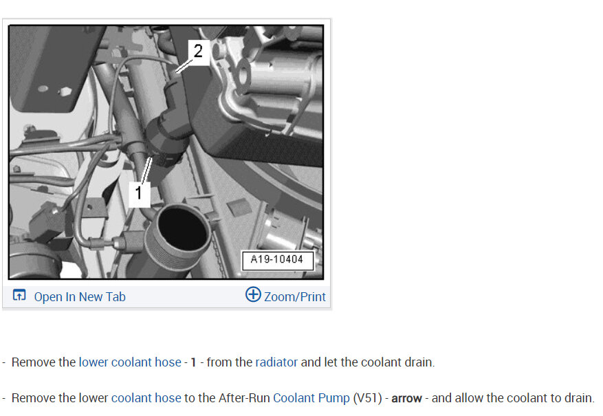

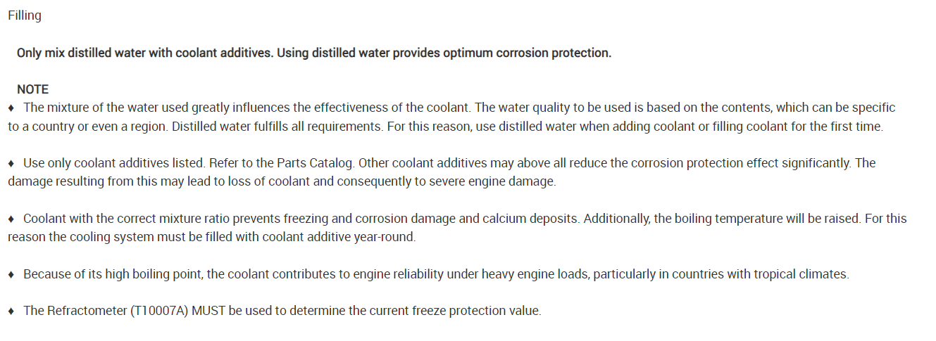

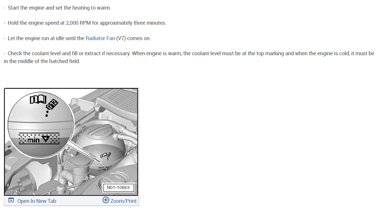

I got a “check coolant” light on my dash today. The reservoir looks a bit low so I’m sure it needs a flush and/or refill. Am i able to simply just add coolant to the reservoir? If so, how long can i safely use it that way? I don’t recall changing the coolant in the 5 years since I’ve owned it.
Oct 11, 2024 at 5:09 AM
  • 55,423 POSTS

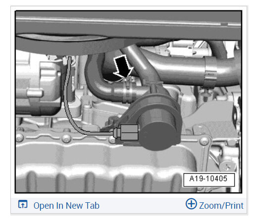

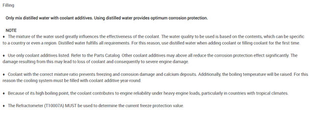

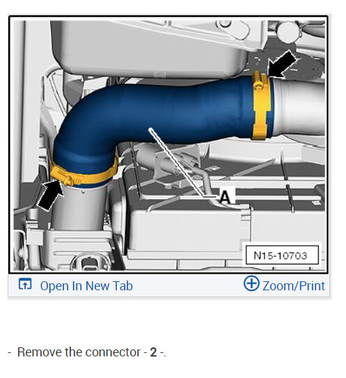

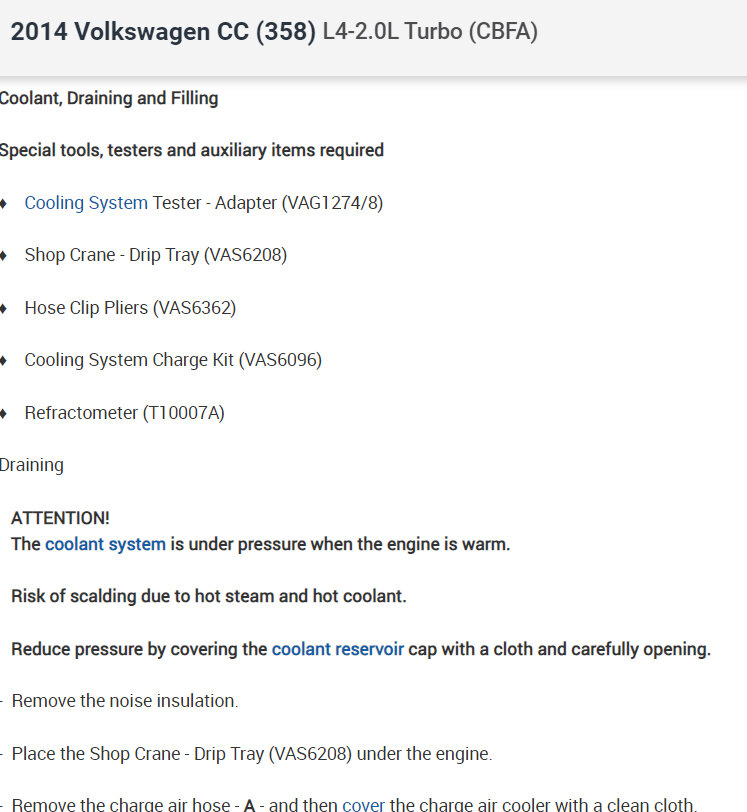

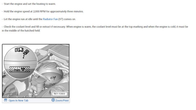

Yes, you can just add coolant, but if it has been a while I would do a drain and fill with new coolant.
Here is a guide to help with instructions below for your car:
https://www.2carpros.com/articles/coolant-flush-and-refill-all-cars
