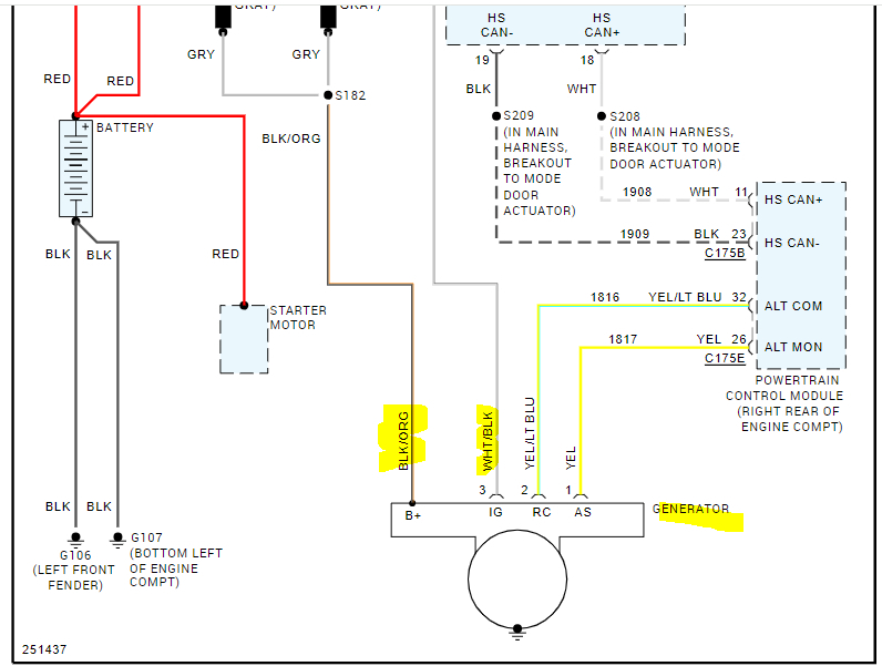

Put on 3 alternators, a brand-new battery and starter. And the battery light keeps coming on telling me to check the charging system.
Oct 5, 2024 at 9:46 AM
  • 110,240 POSTS

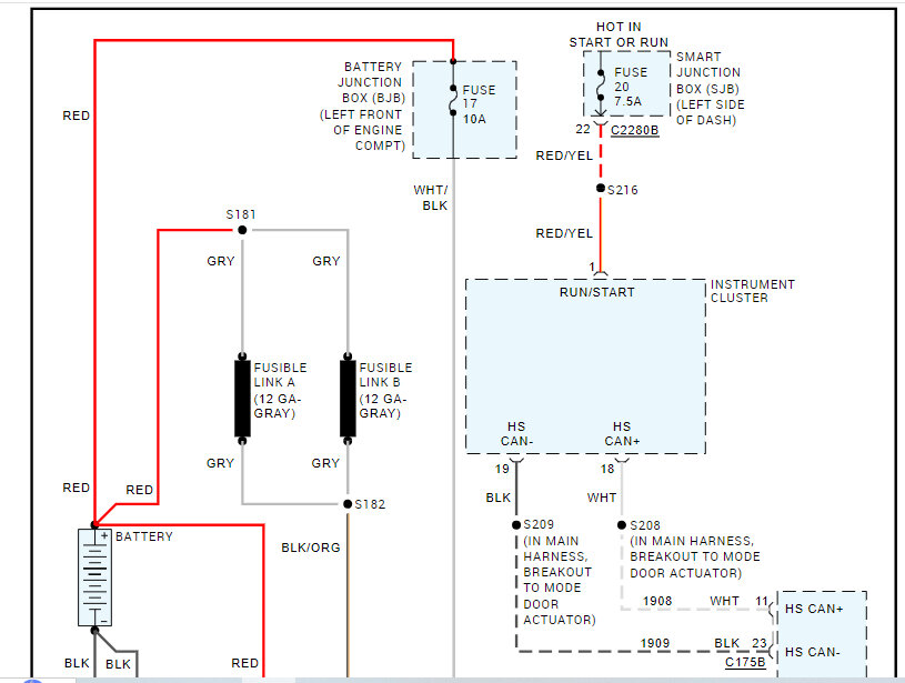

Is the battery staying charged or does it get weak? If that is the case, I need you to check something for me,
At the alternator, you will find a black wire with an orange tracer and a white wire with a black tracer. Both of these wires should have power at all times. I need you to confirm they do.
I attached the charging system wiring schematic below so that you would have a reference. I highlighted the two wires I am referring to.
Let me know what you find.
See pics below. Note: I had to cut the pic in half to make it readable.
