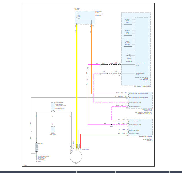

I've replaced alternator and battery. Had charge system checked all voltage readings are good. Check charge system comes on about fifteen seconds after I start car. I've checked all connections and wiring. Can't figure out why I still get warning light. Any ideas?

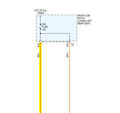

Okay, I attached a wiring diagram for you to view. Check the fuse listed for power on both sides.

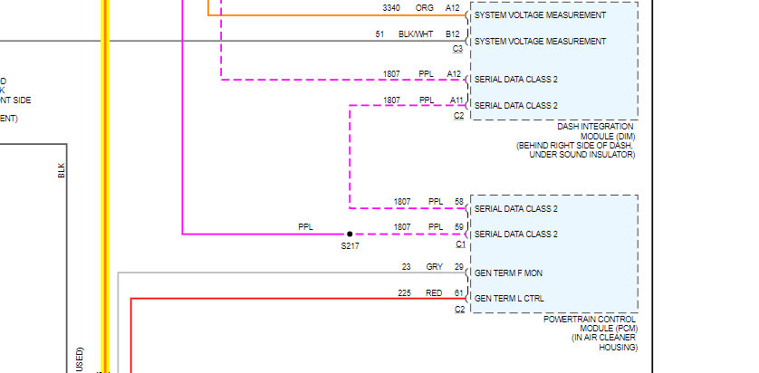

Also, there is a DIM or dash integration module which controls the alternator load.
Do you have a scan tool to monitor the activity of this module?
