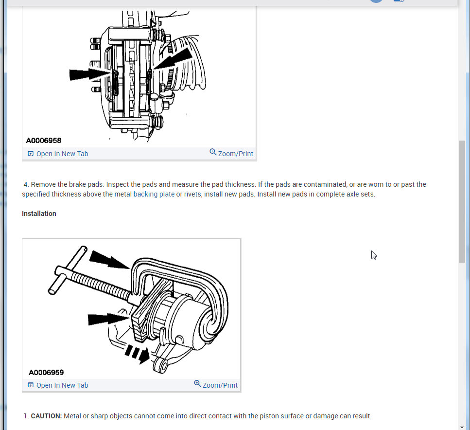

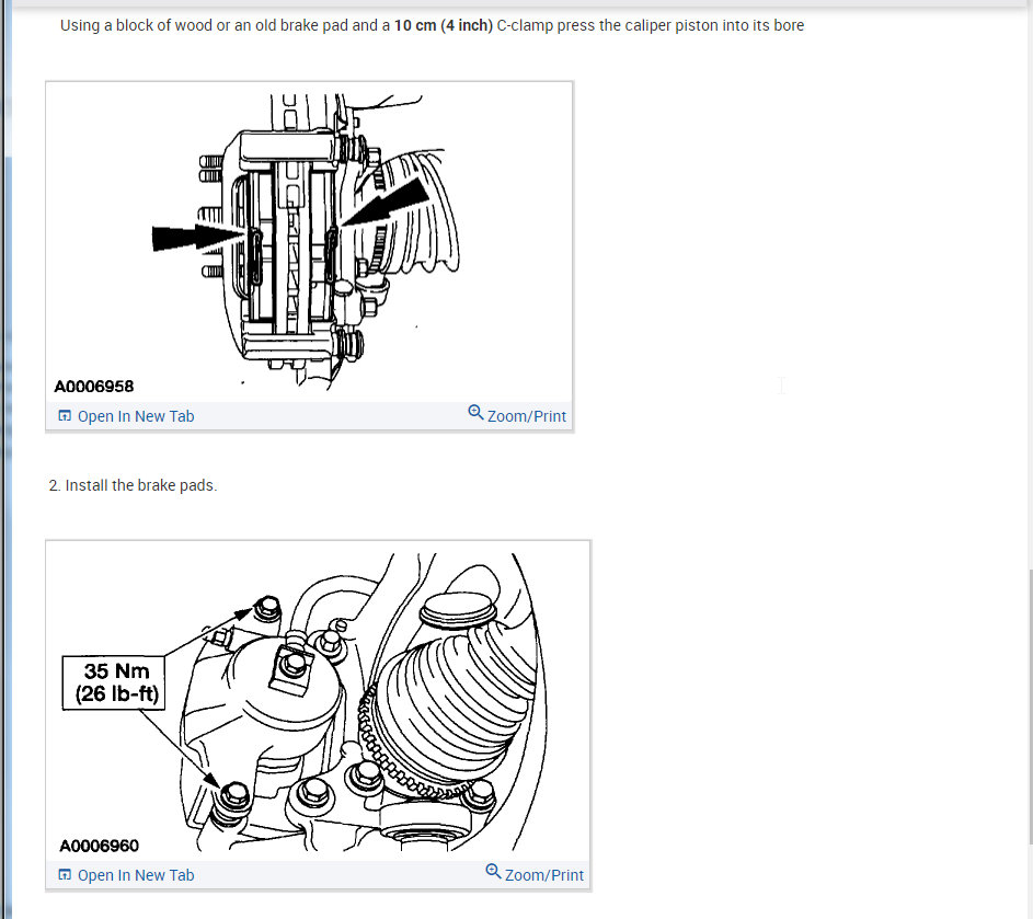

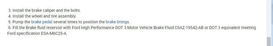

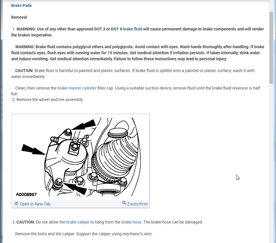

https://www.2carpros.com/articles/how-to-replace-rear-brake-pads-and-rotors
I attached the process below on how to replace the brakes as I suspect that is what is going to need to be done. Let us know this info and we can go from there. Thanks
