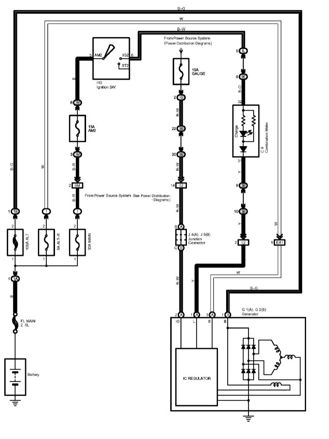

check battery light is on
2005 TOYOTA COROLLA
260,000 MILES • 1.8L • 4 CYL • 2WD • AUTOMATIC
ASIKES73
Charging system light is on. I've replaced the battery and alternator which took care of the problem for a day but now It's dimly lit. I'm looking for an electrical diagram to trace what could be causing this issue.

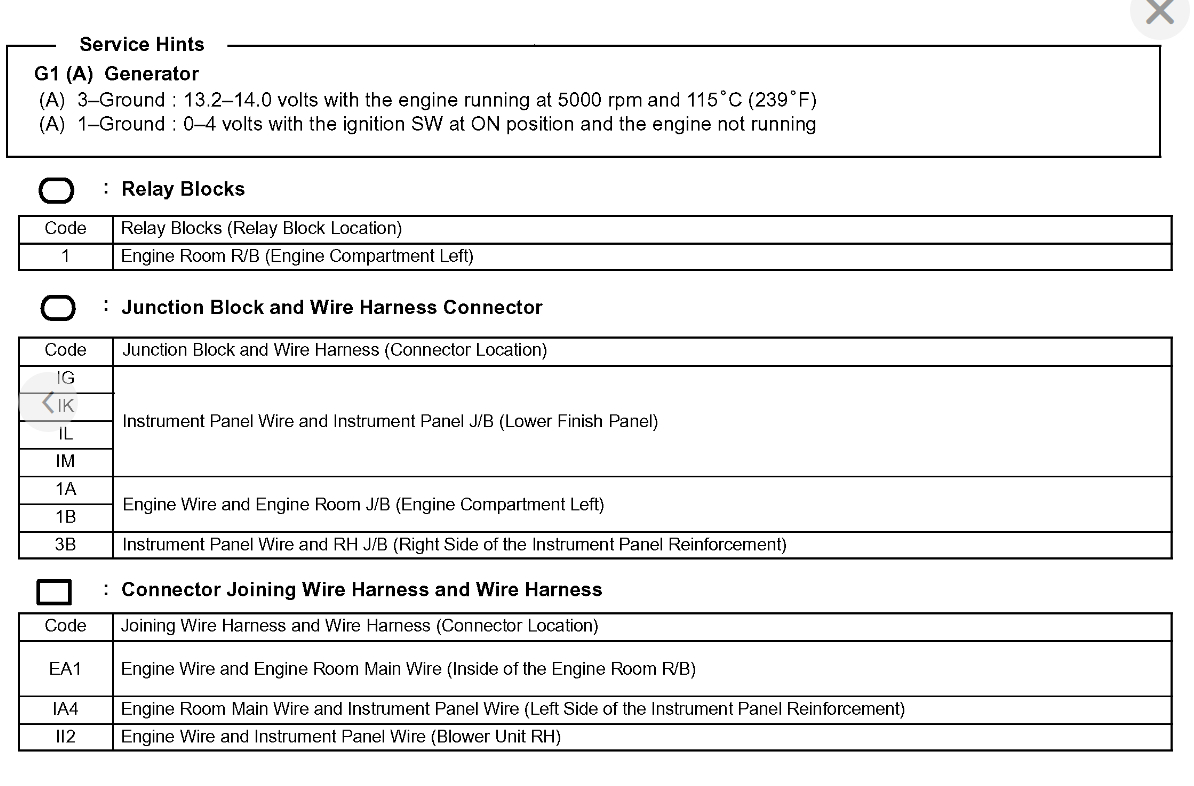

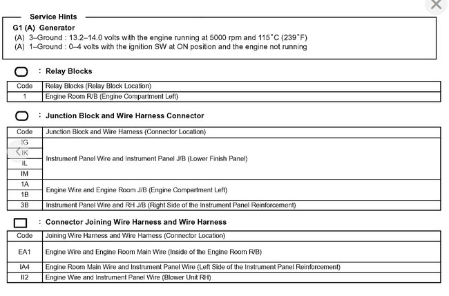

It does sound like it could be a wiring issue.
Have you tested the alternator to see what the output to the battery is?
It is possible to have a fault with the warning light itself.
I have attached the wiring schematics for the charging system for your vehicle.
