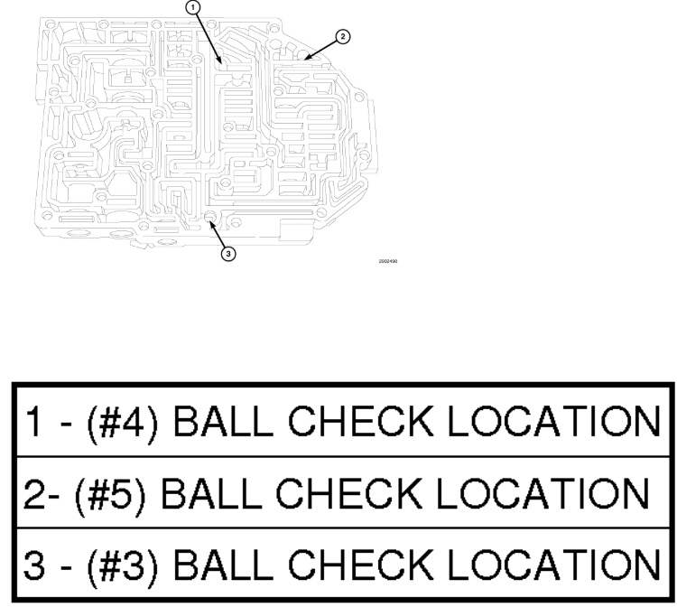

Need to figure out proper check ball position. There are three check balls, but four possible placements.

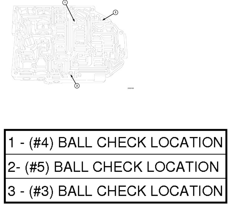

Balls, balls three check balls, lol, here they are. Check out the images (below). Let us know if you need anything else.
