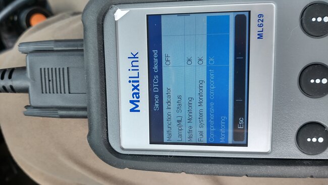

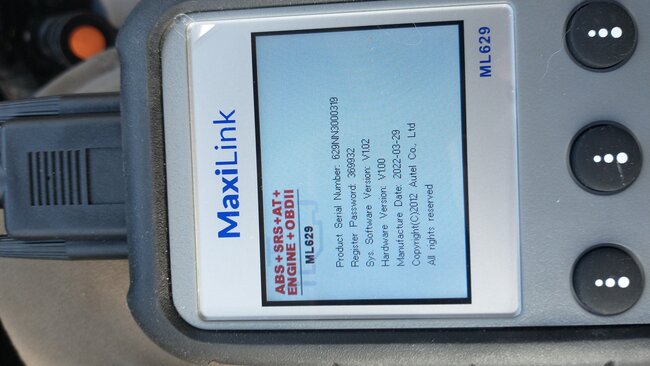

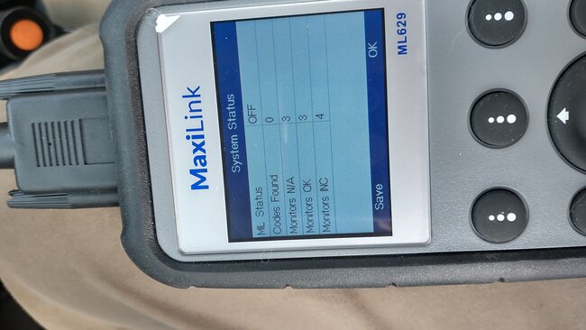

I bought a Autel MaxiLink ML629.
Has CAN on it.
So, here is a question:

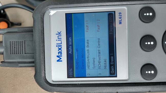

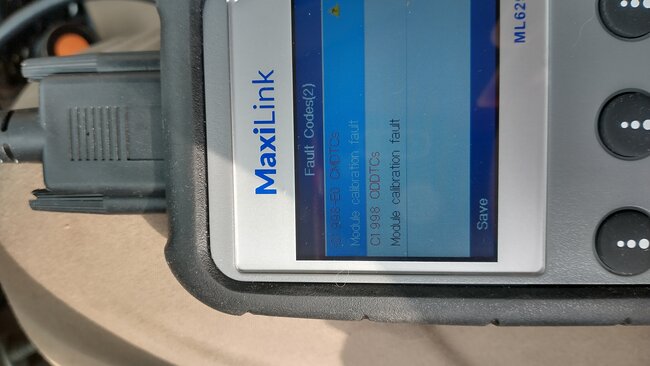

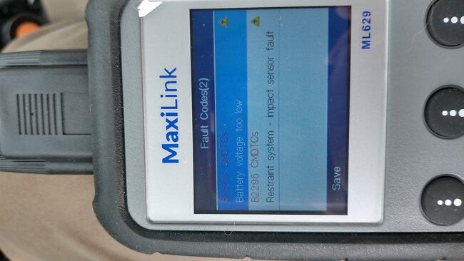

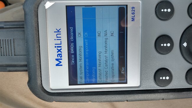

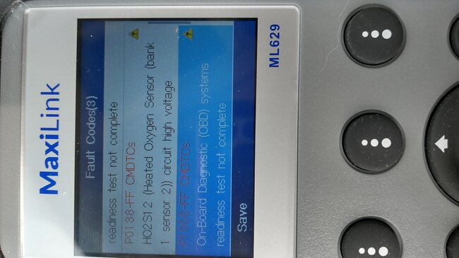

I cleared codes some weeks ago with a Bluetooth scanner.
So, I have no CEL.
But when I hook up the new scanner, I see it sees DTCs for PCM, ABS and SRS.
Why weren't these cleared when I erased codes before and CEL went off?
Or are they "pending" codes?

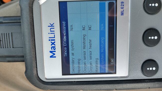

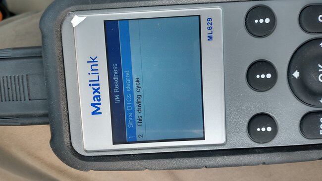

And do I need to clear all codes even though CEL is off in order to reset I/M Readiness
Monitors for state inspection?
See images Apologizes for number of images!
Thanks!
Nov 1, 2022 at 5:55 AM
  • 110,244 POSTS
If you clear the codes again, you have to start over for the readiness. As far as the pending codes are concerned, the computer is waiting to see if they happen again within approximately 40 run cycles. When I say run cycles, that includes driving the vehicle until the operating temp is reached. You can't just start and turn it off 40 times.
Once the required number of run cycles is reached without an issue, the codes should go away.
