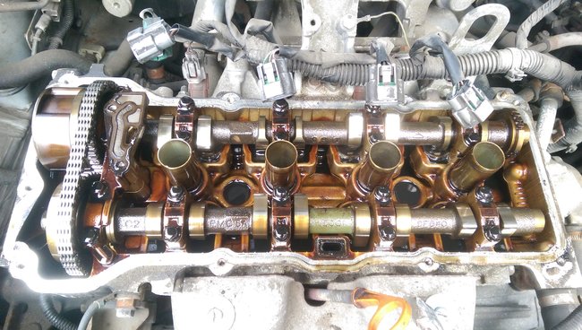

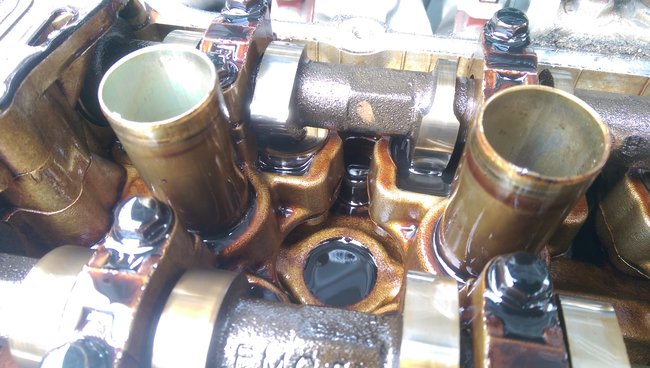

So I've got the valve cover off and realised that the valve springs and stems are completely enclosed in the head, without taking the camshafts off I'm not sure how to check the seals. Unless you know any different?
Jul 6, 2017 at 12:48 AM
HMAC300
  • 48,601 POSTS
yes cams have to come out then there is a special tool that removes and installs the new seals.
Jul 6, 2017 at 1:09 AM
NICHOLAS WRIGHT
  • 7 POSTS
Aaah crap, so I'll have to do the timing on the engine if I do that, but I don't need to remove the head?
Jul 6, 2017 at 1:59 AM
HMAC300
  • 48,601 POSTS
no the head doesn't need to come off, you will need to put air to cylinders to keep valves closed while replacing the seals otherwise valves may drop into cylinder which would require you to pull head then.
Jul 6, 2017 at 2:30 AM
NICHOLAS WRIGHT
  • 7 POSTS
Right, time to look at buying seals and how to redo the timing then I guess, thanks for the help, I'll keep you updated
