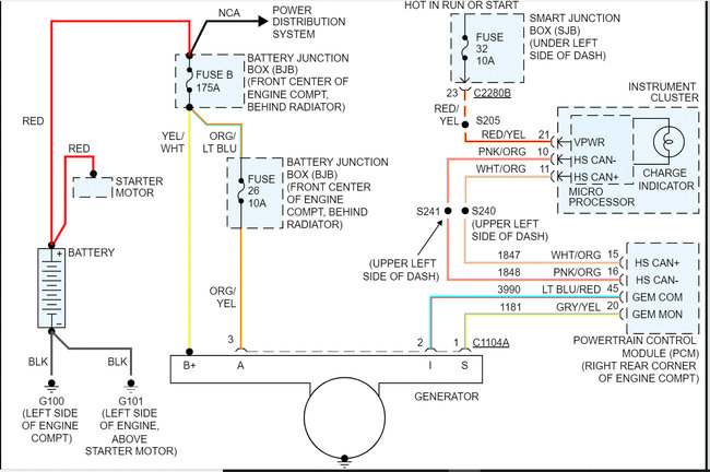

With the car the battery is 12.3 volts.
When you start the car drops to 11 volts.
Disconnecting the plug at the alternator
will bring back voltage to 12 plus at the battery.
What is causing the drop to 11 volts, when
removing the little connector?

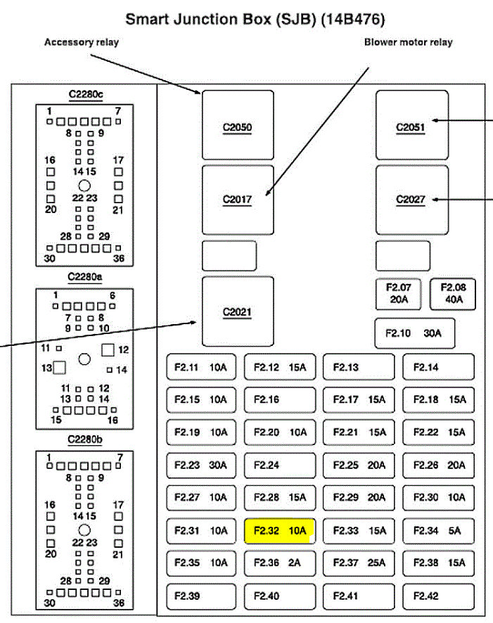

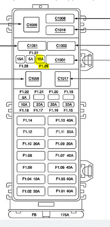

The alternator isn't charging the battery. When you start the engine, the electrical draw from all the different modules, lights, fuel pump, and so on all require power to work. Since the alternator isn't producing voltage, the battery is working alone. Thus, you have a lower voltage.
First, confirm fuses are good. If you look at the last three pics below, they show fuses related to the alternator. Check them. Make sure there is power to and from them as well. Here is a link you may find helpful. Note, there is a 175-amp fuse tied with the alternator as well. See pic 4 below. I didn't highlight it because I feel it likely isn't the cause but check it if you find a power issue to fuse 26 in the under-hood fuse box.
Since you already checked the voltage, it sounds like the alternator needs replaced, especially if the fuses check good. You can remove it and have it bench tested at most parts stores. They will be able to confirm if it is working. Also, most will do it free of charge.

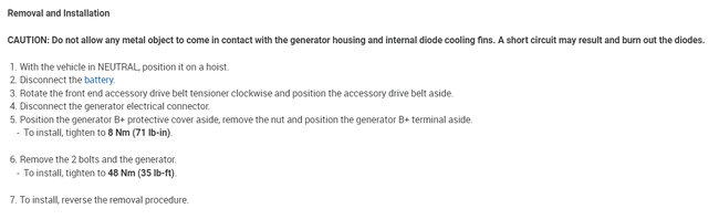

Here is a link that explains in general how one is replaced. You can use this to help guide you through the replacement process.
https://www.2carpros.com/articles/how-to-replace-an-alternator

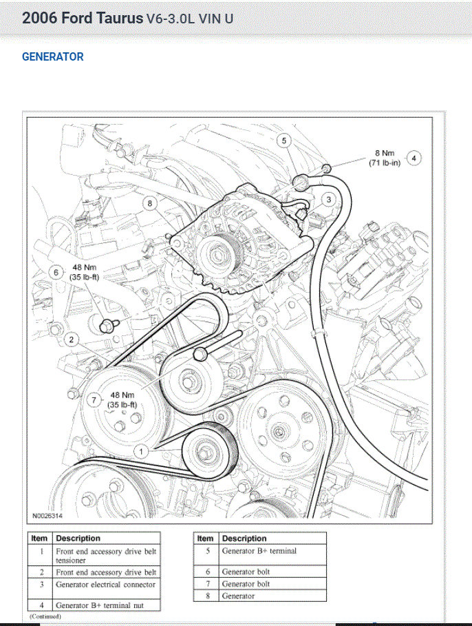

If you look at the two pics below, they are from the manual specific to your vehicle. When you work on the alternator, please make sure the battery is disconnected first. (Pics 1 and 2) Pic 3 is the wiring schematic for the charging system. I added it for reference.

Whoa Joe. That was quit!
I will check everything again, in a few but in the meantime, my curiosity
is why the voltage on the alternator and battery goes up to 12 volts when
I disconnect C1104, the connector on the alternator.
When I check voltage at the main cable on the
alternator that goes to Fuse B in your pics
1: With connector ON = 10-11 Volts
2: With connector OFF = 12.3 Volts.

That connects to the GEM (generic electronic module). You are drawing more power when it's connected because you have connected more electronics.
In this case, since it doesn't go above 12.3v, there is a good chance the alternator is bad. I would remove it and bench test it to confirm. Most parts stores will do it free of charge.
Let me know if you have other questions or if I can help in any way.

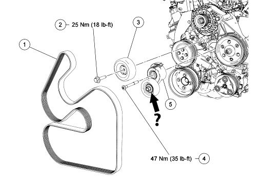

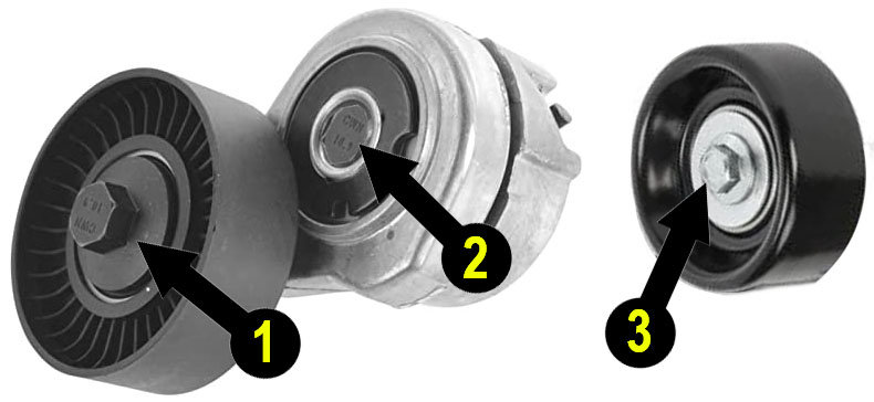

However, I found conflicting info on the service manual.
Can you let me know "The Right Torque" for the 3 indicated bolts?
Idler wheel will be replaced, but the wheel of the Tensioner needs to re-tied-up.
Thanks....

Did you have the alternator bench tested to confirm? As far as the torque specs, the only one indicated in the manual for the tensioner is 18 ft/lb. The idler pulley is 35 ft/lb.
Jan 10, 2022 at 7:40 AM
GONDAR PERSON
  • 25 POSTS
No matter what, that alternator is making noise when you turn it by hand.
Now, this pic shows what my manual indicates, however the one marked with
the arrow, lost pressure by mistake, need to tie back, 18 -20?
Jan 10, 2022 at 9:40 AM
  • 110,248 POSTS
Yep, that's the tensioner. 10 to 20 ft/lbs should be fine.

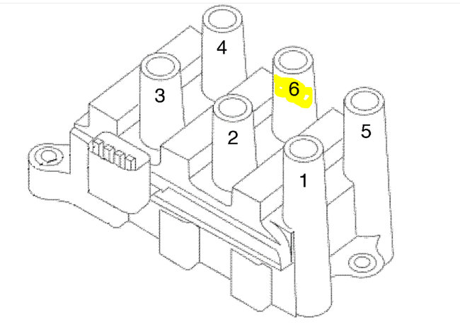

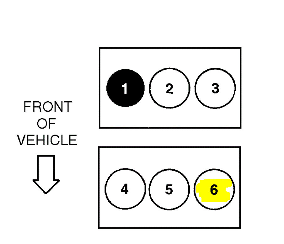

What I got from my Scanner: P0306 Cylinder number 6 misfiring.
Jan 14, 2022 at 2:20 AM
  • 110,248 POSTS
That is specific to that cylinder only. Make sure the spark plug wire at the coil wasn't damaged, shorting, or loose. Follow it from the coil to the plug.
Let me know what you find. I attached pics below showing the coil and engine cylinder locations for cylinder 6.

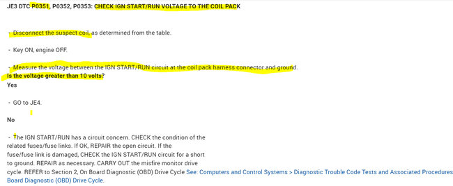

Well, I read the codes again, and again Cylinder #6 miss-firing but.
P0351 that's the ignition coil but pointing at cylinder 1?
Okay, let's put 2 and 2 together, alternator, low voltage like an overload.
Do you get my drift? This may have been the original problem that overloaded
the alternator, so I went and grabbed a new coil pack, and also a spark plug.

It could be the coil pack. Do me a favor, if the repairs you do make no difference, I want you to follow the diagnostic test below. It's simple.
Let me know what you find and how things turn out for you.
See pic below.
Jan 24, 2022 at 8:14 AM

P0351 Cylinder 1? That was my clue, nothing wrong with cylinder #1. So, you may call me crazy, but I see that someone above is telling me what the problem is and read my theory again. so, without any further testing I went and got the coil pack, put it in, and this baby is flying like before! I put it on the expressway and went smoothly, no vibrations, no nothing! I think my theory on the overloading the diodes on the alternator was right, and the cause of everything was the coil pack. What do you think my friend?
Jan 24, 2022 at 8:46 AM
  • 110,248 POSTS
I think you have done it!!! Good job!!! The idea of overloading is questionable, but you got it working properly again, and that is what matters.
Regardless, I'm happy to know it is running properly again for you. Please feel free to come back anytime in the future if you have questions or need help. You are always welcome here.
