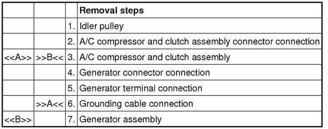

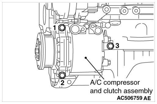

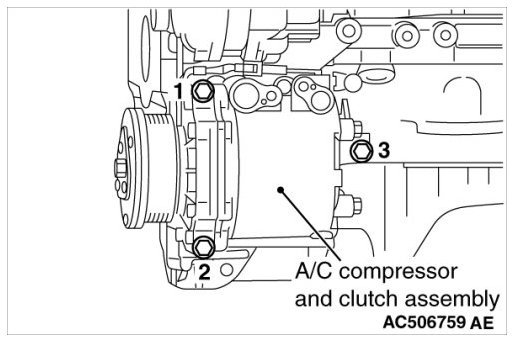

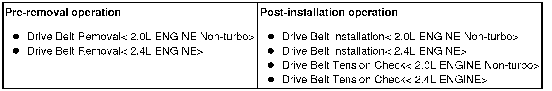

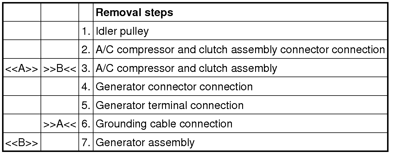

REMOVAL AND REPLACEMENT
REMOVAL AND INSTALLATION [2.0L ENGINE NON-TURBO, 2.4L ENGINE]
pic 1
pic 2
pic 3
REMOVAL SERVICE POINTS
[[A]] A/C COMPRESSOR AND CLUTCH ASSEMBLY REMOVAL
1. With the hose installed, remove the A/C compressor and clutch assembly from the bracket.
2. Tie the removed A/C compressor and clutch assembly with a string at a position where it will not interfere with the removal and installation of the generator assembly.
[[B]] GENERATOR ASSEMBLY REMOVAL
Remove the generator assembly to the downside.

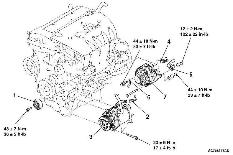

]]A[[ GROUNDING CABLE INSTALLATION
pic 4
1. Install the grounding cable within the area marked with A in the illustration.
2. Tighten the generator assembly mounting bolt to the specified torque.
Tightening torque: 44 ± 10 Nm (33 ± 7 ft-lb)

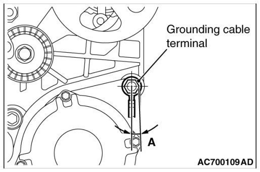

]]B[[ A/C COMPRESSOR AND CLUTCH ASSEMBLY INSTALLATION
pic 5
Tighten A/C compressor and clutch assembly mounting bolts to the specified torque in the order of number shown in the illustration.
Tightening torque: 23 ± 6 Nm (17 ± 4 ft-lb)
