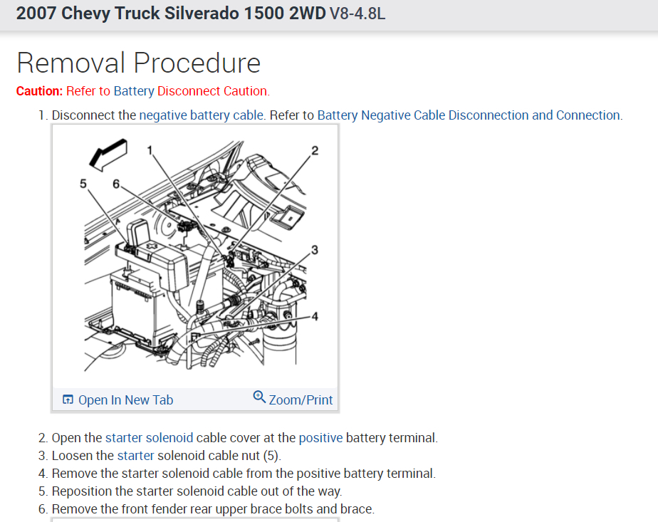

I have the Optima six pack battery with side and top post, battery drained out and when I charged it, the side post shows full charge but the top post still showing no charge I need to replace it.

Here is a guide to help you step by step with instructions in the diagrams below to show you how on your car.
https://www.2carpros.com/articles/how-to-replace-a-car-battery
