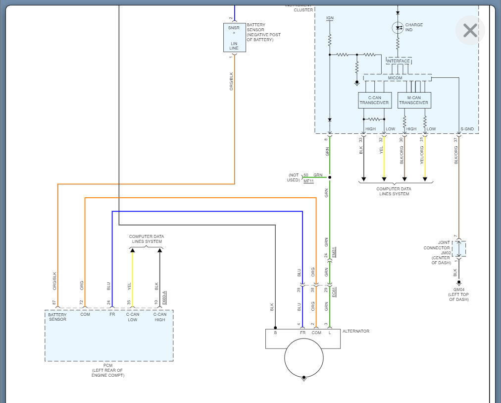

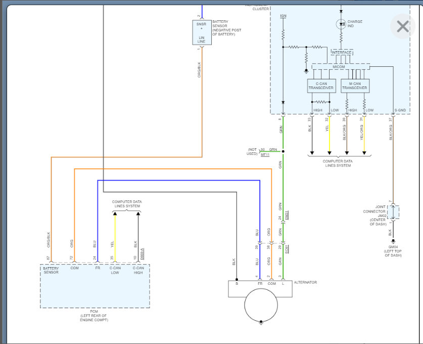

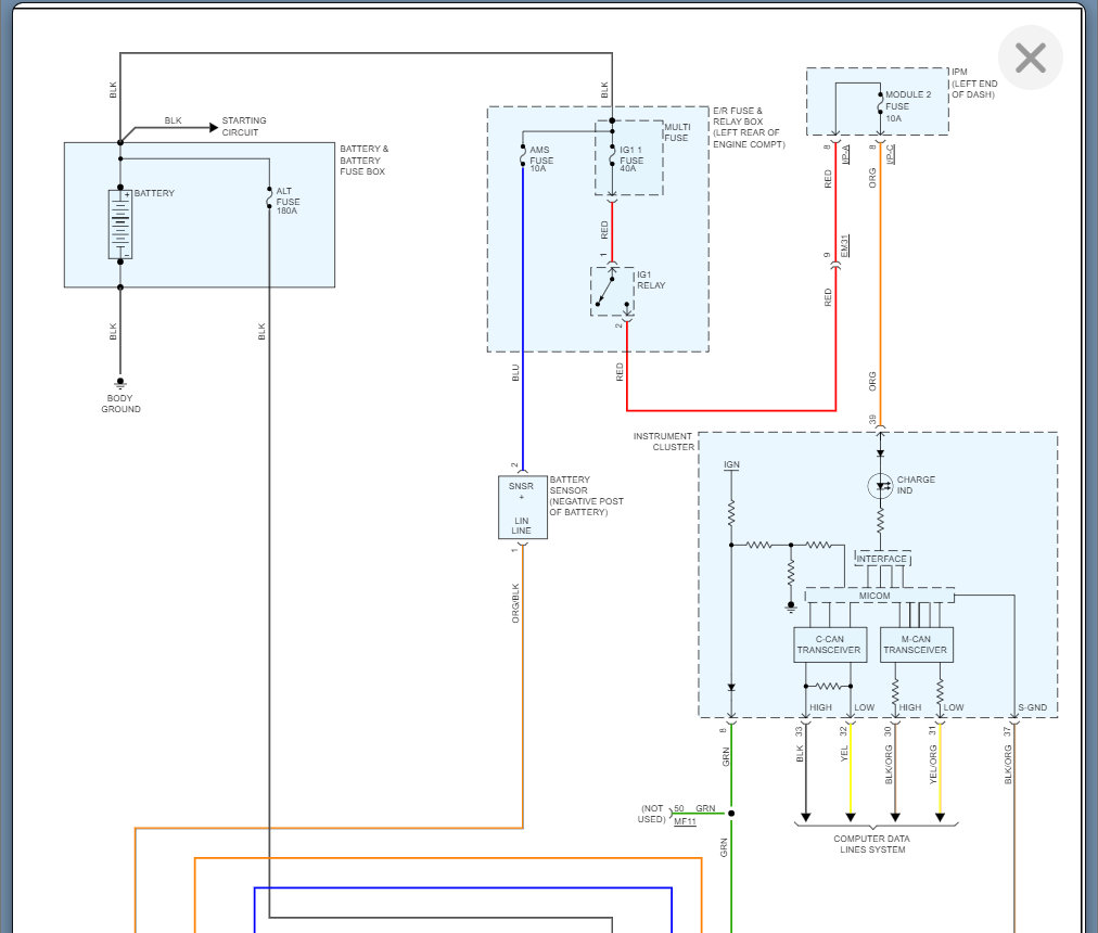

Okay. That means we need to move onto checking the voltage at each of the wires at the alternator when the engine is running. Basically, we need to make sure we have proper command for the alternator to charge the system.
He is not wrong that this could be due to it being an aftermarket alternator, but we need to rule these other things out first as it is unlikely to replace the alternator and it still has the same issue and the currently alternator pass a load test.
I attached the wiring diagram above which is what we are going to need in order to figure this out.
Jun 2, 2022 at 2:08 AM
BLACKMON
Okay, which wires should I test for voltage?
Jun 2, 2022 at 3:20 AM
All four of them. Take a look at the wiring diagram and let me know what questions you have.
Thanks
Jun 2, 2022 at 3:59 AM
BLACKMON
What voltage should each wire read? And the plug has only three wires. No black wire.
Jun 2, 2022 at 11:23 PM
Okay. You should have three wires on the connector and then there is a separate wire that will be the 12 volts battery feed.
So, this separate wire should have 12 volts. The blue wire is the field wire, and the voltage is going to vary on this depending on what the alternator is being commanded to do. The Orange wire is the com wire or the signal return from the alternator to tell the PCM what the alternator is outputting.
The last green wire is going to be the signal to turn the light on in the cluster. Basically, this wire is going to read the alternator output. So, I am interested to see what they are all reading and depending on the load we will know what is correct or not.
Take these measurements with the AC on max, the lights on inside the vehicle and the headlights on. This will require the alternator to run at max output.
