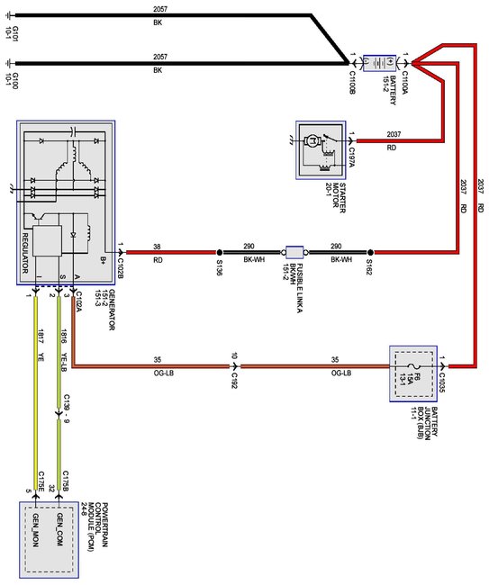

Replaced alternator shows charging at 14.2, but battery light on.

Check the voltage output at the yellow wire at terminal one. A bad connection/broken wire there won't send a signal to the PCM telling it that the alternator is working.
