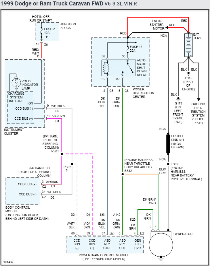

Will not charge. New alternator, new battery. I was told voltage regulator.
Feb 15, 2018 at 11:48 PM
SQM
  • 6,383 POSTS
Please note that the voltage regulator is part of the alternator. A new alternator will come with the voltage regulator built in.
This could be a wiring issue. You could have a short or a bad ground in the charging system harness.
It can also be a burn fusible link. This vehicle has a 10-gauge fusible link for the alternator. It is located in under the dash fuse box.
I have attached the wiring schematics for your reference.
