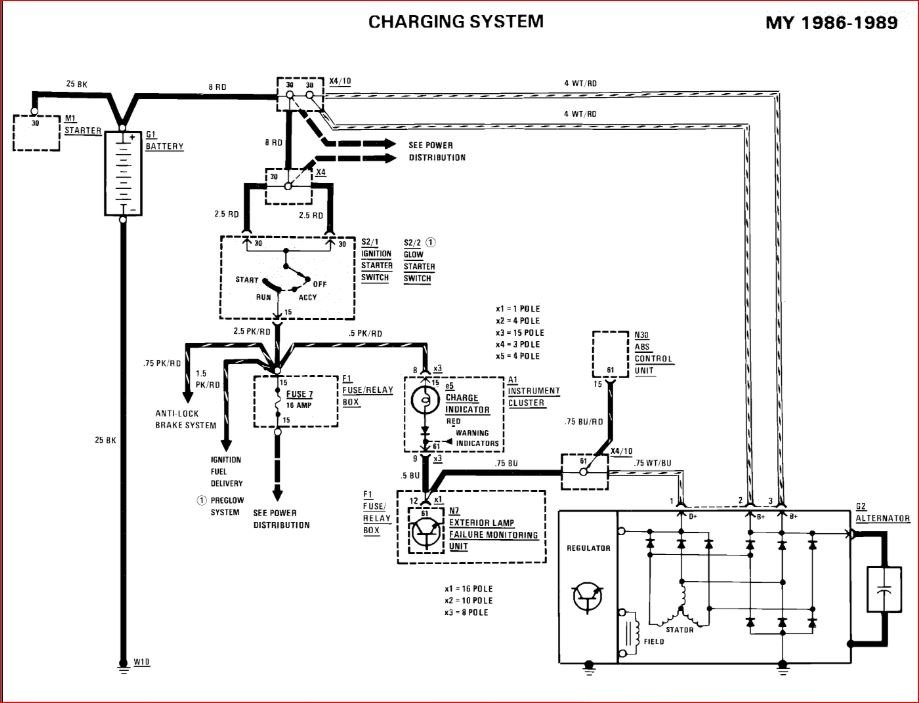

The car wasn't charging so I replaced the battery with a new one and we replaced the alternator with a brand new one. Still not charging.

The next possibility is the wiring to the alternator. I included a wiring diagram so that you can see where they go. We need to disconnect them at each end and measure resistance. This will make sure they are not open or have high resistance robbing voltage.
Let me know what you find with this stuff and we can go from there. Thanks
