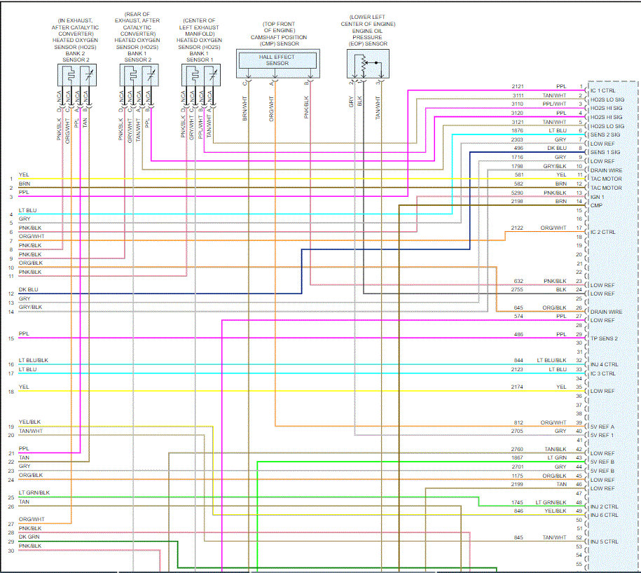

I need readable multi color power and ground distribution electrical diagrams of the following:
1. BCM 1, 2 and 3
2. ECM
3. PCM

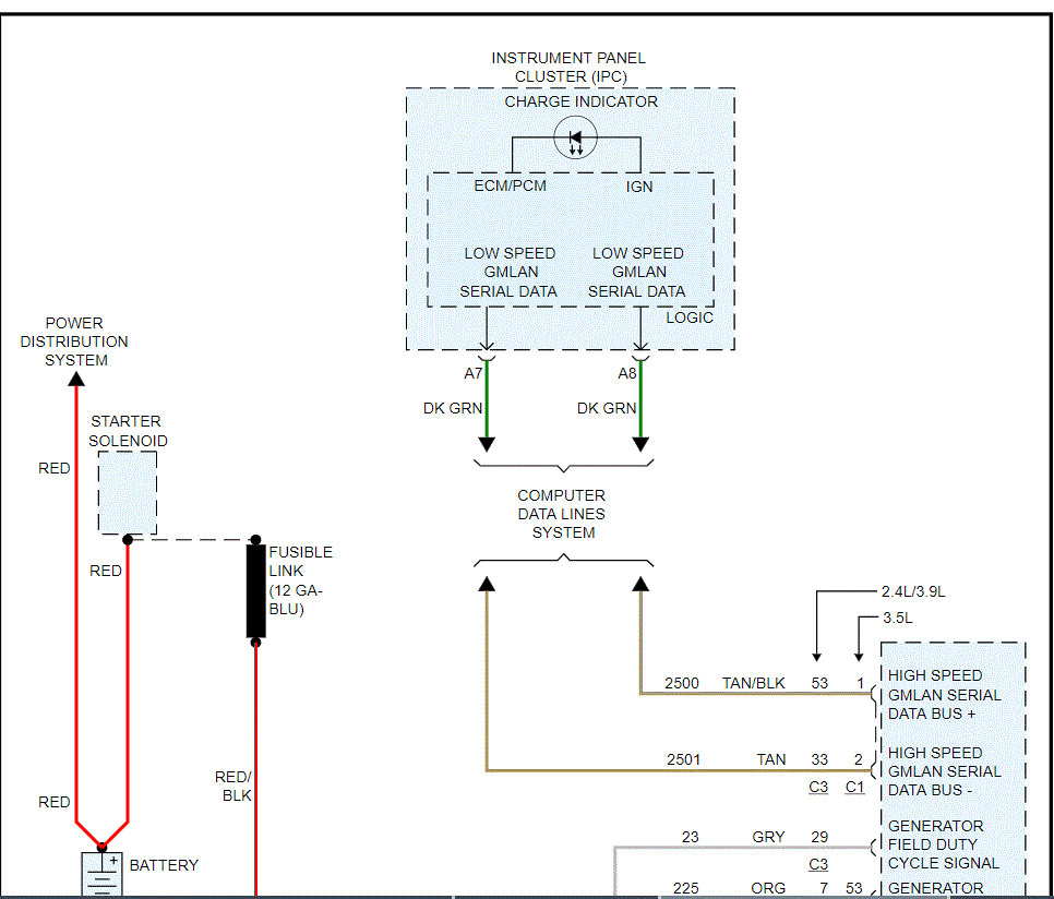

6. Generator F (alternator to starter and battery and IPC)

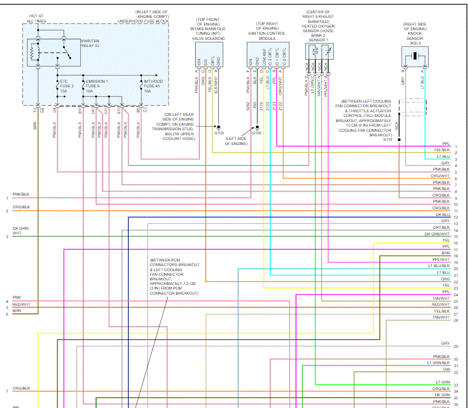

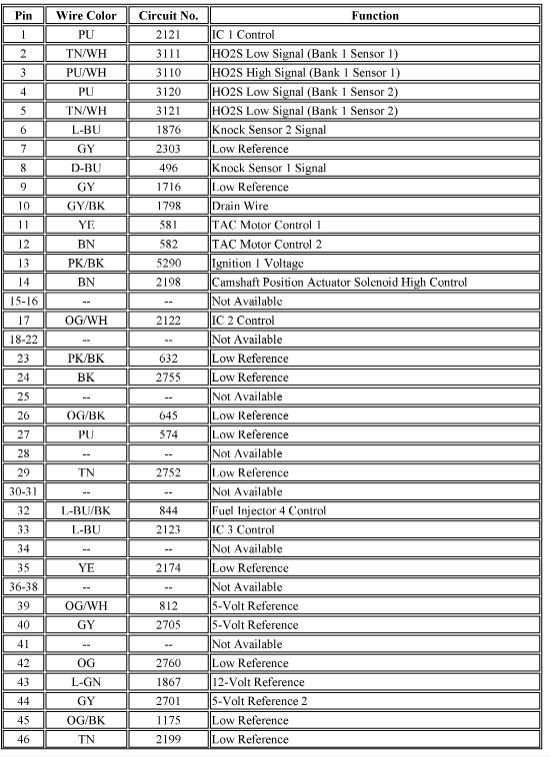

Here are some of the diagrams for ECM and BCM. i will send more shortly. I hope this is what you need.
Feb 10, 2020 at 7:23 AM

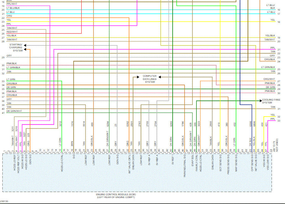

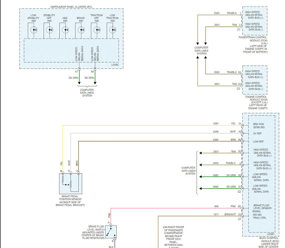

The first 8 pictures are of the entire power-train control. The next two are of the charging, then the starter, then the ABS. I overlapped everything so you can follow them.
Let me know if this helps.
