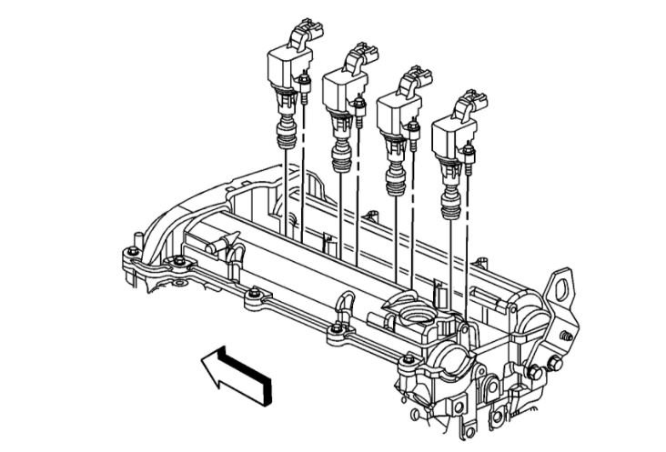

Want to change spark plugs (do it myself) how difficult would it be?
Thanks. Gary

Good morning.
Not hard at all. remove the coils, one bolt holding each and then remove the plugs.
1. Remove the ignition coil(s). Refer to ignition coil replacement (See: Ignition coil removal and replacement).
Note: Make sure that any water and/or debris is blown out of the spark plug holes prior to removing the spark plugs.
2. Remove the spark plugs using a 5/8 inch spark plug socket.
