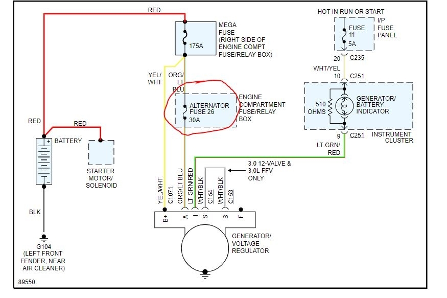

I hooked an inverter into cigarette lighter and plugged in a little heater. when I shut it off I guess I blew the fuse not realizing it I later went to the gas station and on the way back I lost all power lighting blinkers everything in the car eventually shut off. I put a jump pack on it and got it back to the house. replaced the fuse, tested alternator charge the started the car will not take a charge. they're both good battery multimeter shows that there is a current with key off in between the battery new alternator. I cannot figure it out I need help.

Good morning,
What is the voltage when the engine is running at the battery? It needs to be 14 to 14.5 volts, otherwise, the battery will drain out.
https://www.2carpros.com/articles/how-to-replace-an-alternator
I attached a wiring diagram of the alternator for you. Check the fuse I circled for power on both sides.
