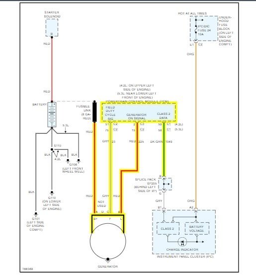

Installed brand new alternator and new battery but still not charging. what else could be wrong?
Jan 23, 2021 at 1:54 PM
Good morning,
Can you tell me the voltage of the battery with the engine running?
The engine ECM controls turning the alternator on and off to charge the battery.
My suggestion is to remove the alternator and take it to a parts store and have them test it on their tester to be sure it is good.

CHARGING SYSTEM INDICATORS
BATTERY
The IPC illuminates the battery indicator when the following occurs:
- The PCM detects that the generator output is less than 11 volts or greater than 16 volts. The IPC receives a class 2 message from the PCM requesting illumination.
- The IPC determines that the system voltage is less than 11 volts or greater than 16 volts. The IPC receives a class 2 message from the Body Control Module (BCM) indicating the system voltage.
- The IPC performs the displays test at the start of each ignition cycle. The indicator illuminates for approximately 3 seconds.
- The ignition is on, with the engine off.
BATTERY NOT CHARGING
The IPC illuminates the battery not charging indicator in the driver information center when the following occurs:
- The IPC determines that the system voltage is less than 11 volts or greater than 16 volts. The IPC receives a class 2 message from the body control module (BCM) indicating the system voltage.

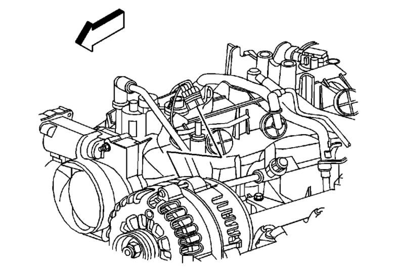

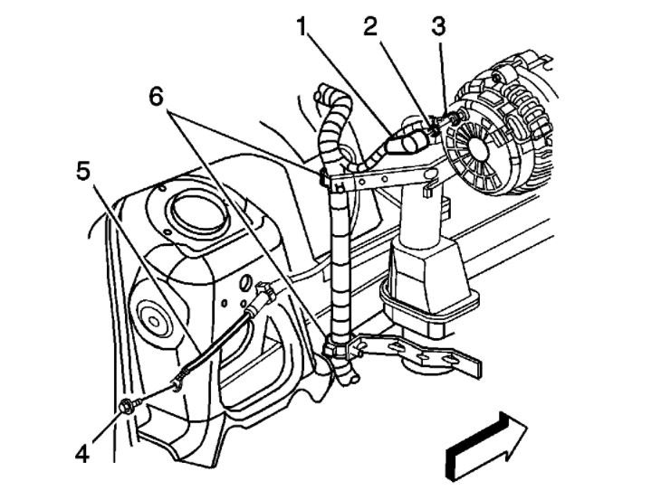

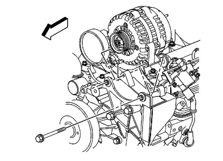

REMOVAL PROCEDURE
1. Disconnect the negative battery cable.
2. Remove the accessory drive belt.
3. Disconnect the generator electrical connector.
4. Remove the generator cable (3) from the generator, perform the following:
4.1. Slide the boot (1) down revealing the terminal stud.
4.2. Remove the generator cable nut (2) from the terminal stud.
4.3. Remove the generator cable (3).
5. Remove the generator bolts.
6. Remove the generator.
