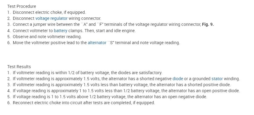

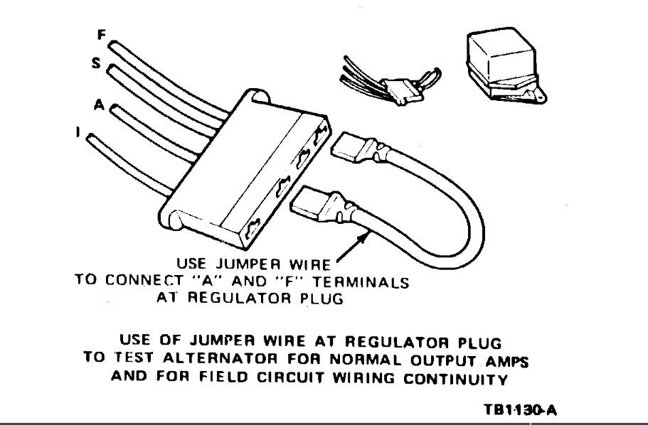

It has a new alternator, voltage regulator, but still won't charge.
Friday, April 10th, 2020 AT 7:56 AM
MECHANIC
52,797 POSTS
Good morning,
Did you verify power to the big terminal on the alternator from the battery?
Check for power to the alternator and the regulator.
What is the charging system voltage running?
