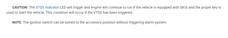

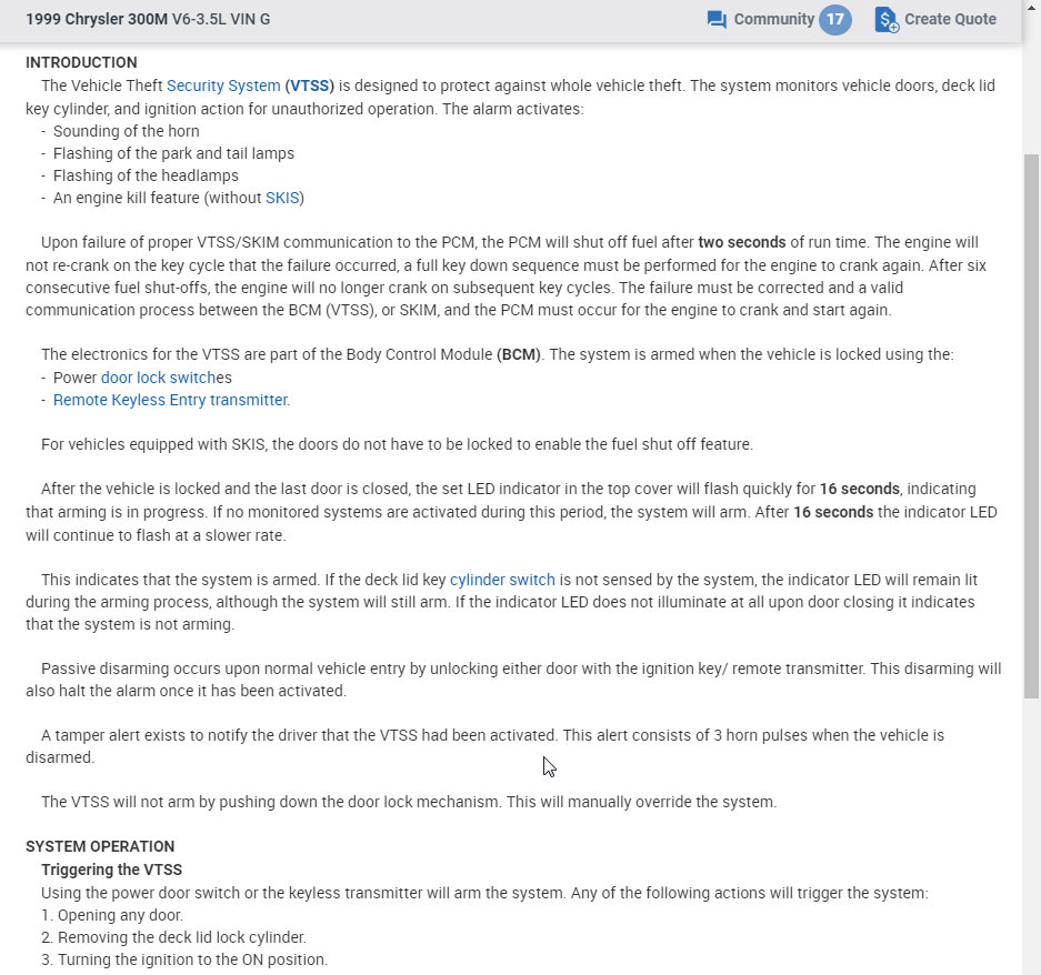

After the first start and stall, does the theft light stay on or flash?
This sounds like we have a key issue or something related to this. I am attaching the information about this system. Take a look at this and let me know if the light is staying on or flashing and we can go from there.
If it is, we will need to check for codes.

oops, on the last reply, i went out and hooked up power again to it and this time i closed the doors and locked them and then the VTSS came on and was blinking.
Oct 7, 2020 at 10:08 AM
Okay. So if it is blinking now, what happens when you unlock the doors and try to start the vehicle? This is sounding more and more like a security issue.

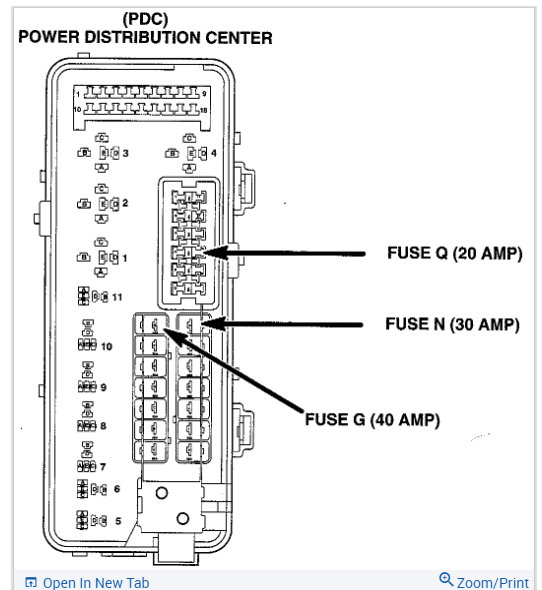

it only lit up when i closed the doors, with extra power on the battery. during removal of power pack i heard little clicks near the battery, which of course is located in the passenger wheel well. otherwise everything is totally off, it doesn't lock or unlock, like resulting a drained battery ,yet it's fully charged.
Oct 7, 2020 at 1:46 PM
Okay. That changes things. The clicking that you are hearing, is this coming from the PDC (pictured) which is under the hood? If it is, we need to touch the relays to see which one is clicking.
A clicking relay is normally low battery power or a faulty relay.
A relay will cause these types of issues. Plus we may want to load check the battery if we haven't done that yet.
The battery voltage may be fine but the amperage is low and it cannot produce the power needed.
