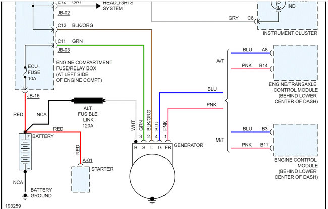

Charging issue, where is the fusible link located?
2005 KIA OPTIMA
112,000 MILES • 4 CYL • 2WD • AUTOMATIC
BROWNG123
I replaced the alternator, the alternator fuse and battery, is there another alternator fuse and where is the fusible link located? Please no diagrams, just explain. Thank you
Mar 24, 2022 at 11:52 PM
  • 110,241 POSTS

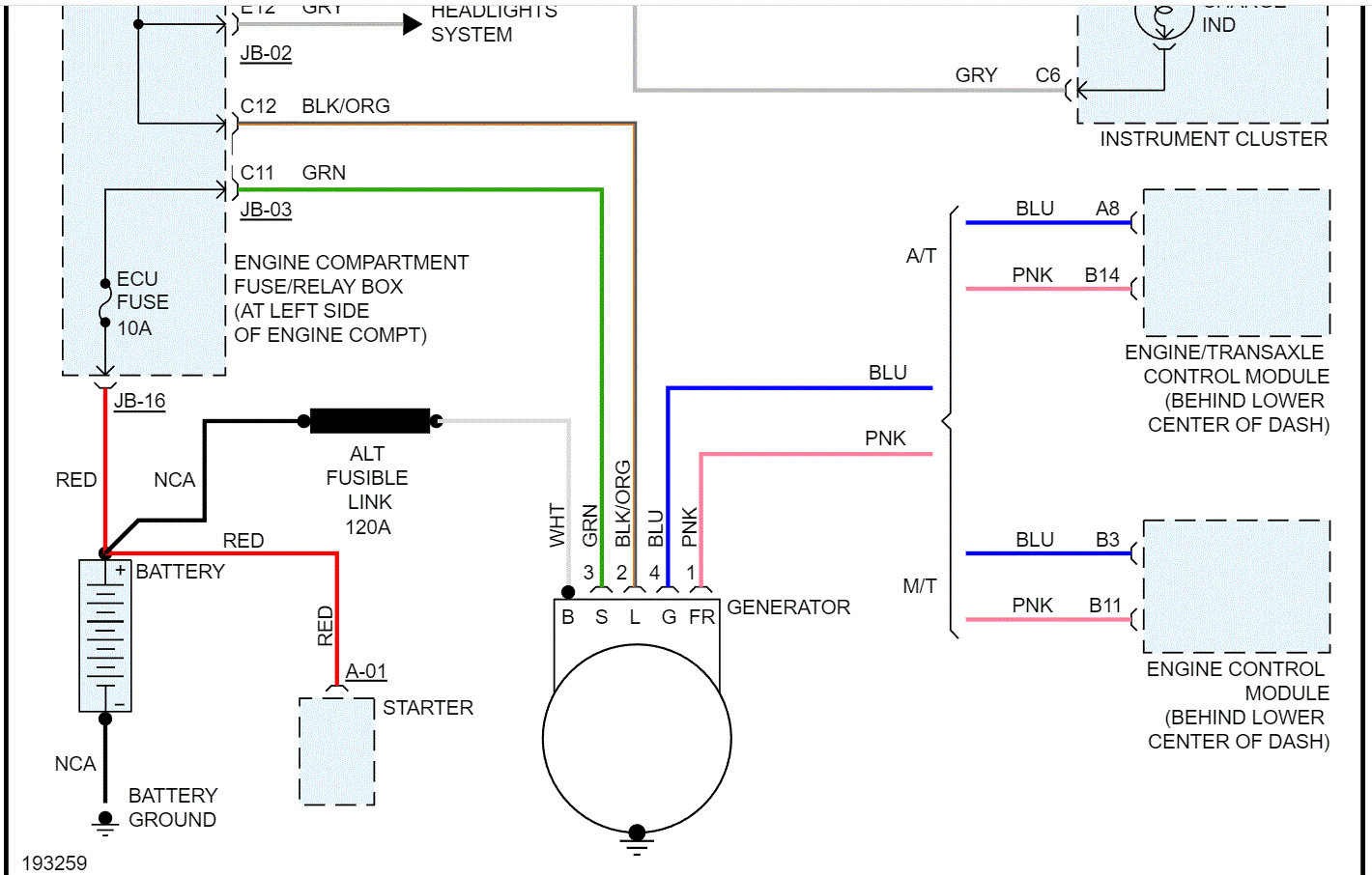

I attached the wiring schematic for this vehicle's charging system. There is a fusible link between the B terminal on the alternator (white wire) and the battery. Check to see if there is continuity at that wire.
