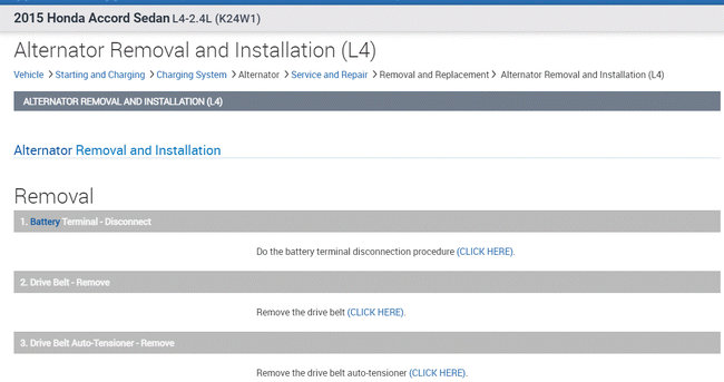

Car never shuts off while driving. But once a trip is completed it won't start without a jumper. After it starts charge is about 12.5v both at battery and at alternator positive cable. Strange, if it was the alternator, she would have shut off i assume while driving at some point. Driven it 40 miles this way with no issue until it is turned off, and again eight miles after that. No battery light on dash. Trickled charged the battery but she still did not start on its own. Corrosion at battery terminal. Cleaned it out but still. I leave it running while looking at the scanner and it is in the 12.34-12:54 range. Is there a fuse first of all before i remove the alternator to have it checked out?

The voltage you see is likely being provided by the alternator. However, it isn't enough. Voltage with it running should be approx. 14v. It is prolonging the battery from going dead when running, but it doesn't recharge it enough to restart the engine. The starter places a large electrical draw on it.
What is the voltage at the battery with the engine off? I have a feeling it isn't much different than what you mentioned.

Voltage at battery with it off is good but when i do a load test it shows it to be weak. No matter what i do while car is running it is still at 11.20-12.60.

It sounds like the alternator is bad. At this point, I would recommend removing it and having the alternator bench tested. I have a feeling it needs to be replaced.
To get you started, here is a link that explains how (in general) to replace an alternator:
https://www.2carpros.com/articles/how-to-replace-an-alternator

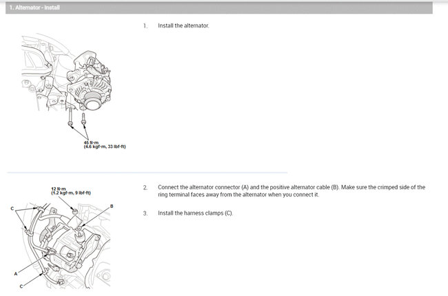

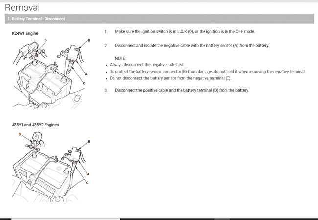

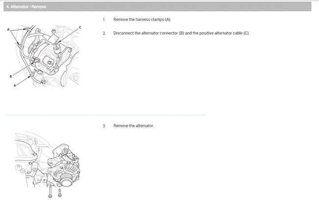

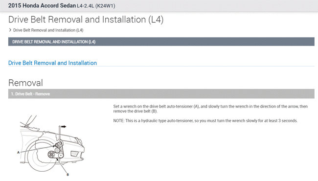

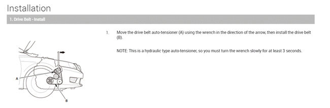

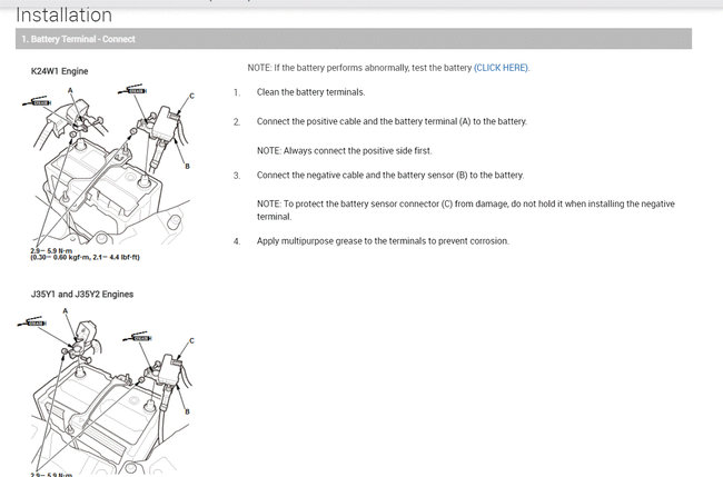

If you look at the attachments below, they are the directions specific to your vehicle for replacing it. The directions start with disconnecting the battery, then the serpentine belt, and finally, the alternator.
Remove it and have it bench tested at a parts store. Normally, there is no charge for having it tested.
Let me know what you find and what I can do to help.

Replaced alternator and all is good. Thanks for your help.
