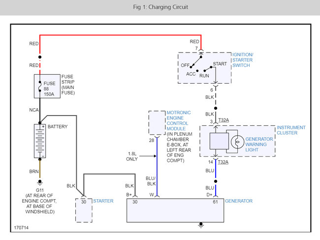

  • 903 POSTS
Battery light would come on sometimes but only after car has been driven for a while, and then if you turn it off and back on it would need jump. Replaced alternator and the volts at battery are 13-13.40 while idling and as soon as i hit the pedal to rev it up it drops to under 12. At the alternator the output is 14.47.

So the voltage at the battery is 14.47 when running? if so the battery might be bad. To be sure lets run down this guide to confirm the issue:

The voltage at alternator is 14.4 at the battery its 13.5, but when i hit the gas pedal while parked it drops to 11.90-12.90 then when i let off it goes back to 13.4 gradually.
May 21, 2021 at 4:18 AM
DIVIDES
  • 903 POSTS
And while parked if i turn the A/C on after its warm it goes from 12.20 fluctuates like crazy until it reaches 13.3.
May 21, 2021 at 4:22 AM
DIVIDES
  • 903 POSTS
Battery replaced twice with new ones.
May 21, 2021 at 4:25 AM
  • 55,433 POSTS
Did it do this with the old alternator too?
May 21, 2021 at 4:37 AM
DIVIDES
  • 903 POSTS
Yes.
May 21, 2021 at 4:41 AM
DIVIDES
  • 903 POSTS
Now says 13.8 but A/C hot, the ambient temperature reading -38. where is the sensor for that?
May 21, 2021 at 7:32 AM
  • 55,433 POSTS
The alternator output is controlled by the PCM but lets check the connections to the alternator to confirm the PCM is going bad. This guide can help I have included the alternator wiring diagrams below so you can see how the system works:
