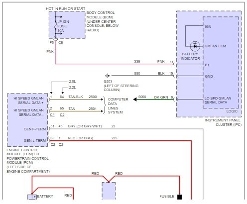

Alternator is not charging and cannot find good detailed diagram.
Sep 13, 2018 at 11:25 AM
CJ MEDEVAC
  • 11,004 POSTS

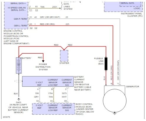

The first diagram stacks on the other (It took two screenshots to get it from "Prodemand"). I insured there was overlap so nothing is lost.
Prodemand diagrams show the locations of items.
I would check out the fusible link!
Here other information that might help too. It is from "Repair Guides" at the top right of our pages.
Let us know what you find.
