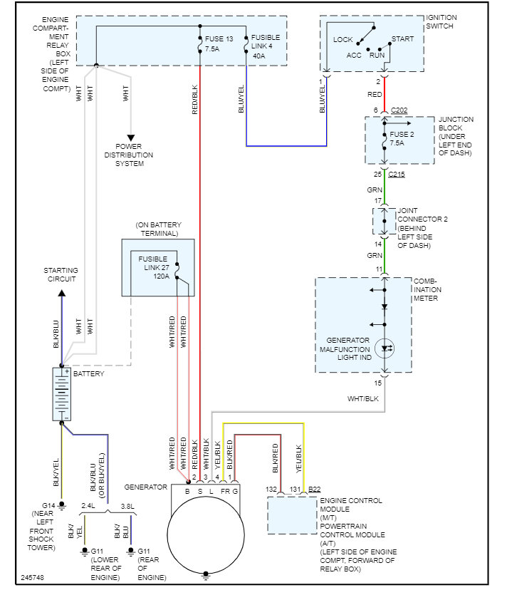

2006 MITSUBISHI ECLIPSE
90,000 MILES • 3.8L • V6 • AUTOMATIC
RICHARDE
I am only getting 2.5 volts from battery connection on alternator to positive on battery. Alternator bad? ECU or maybe fusible link? Please help.
thanks
May 10, 2023 at 2:49 AM
  • 55,214 POSTS

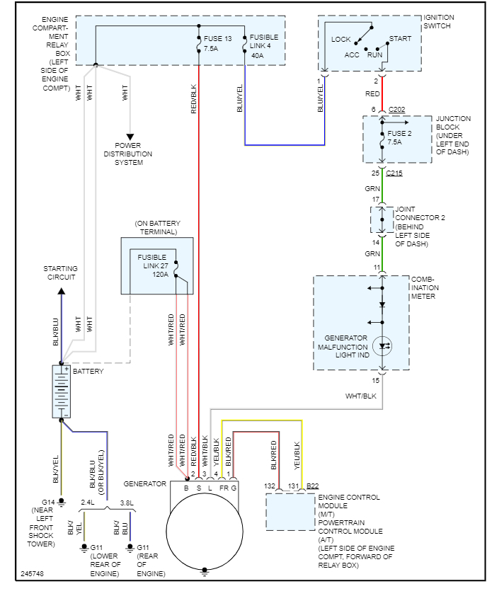

I would check fusible link #27 and #4. here is a guide to help and the alternator wiring diagrams so you can see how the system works:
Check out the images (below). Please let us know what you find. We are interested to see what it is.
