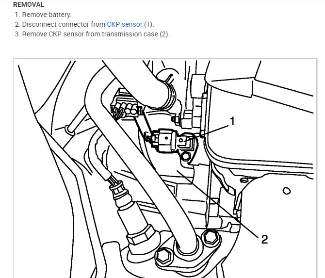

Car does not crank. Gives crank sensor fault. P0335 is the fault code. I want to check connector and sensor type.
Jun 5, 2023 at 8:58 AM
  • 110,194 POSTS
The code is related to the crankshaft position sensor. If it has failed, you will lose spark to the plugs, and it won't run.

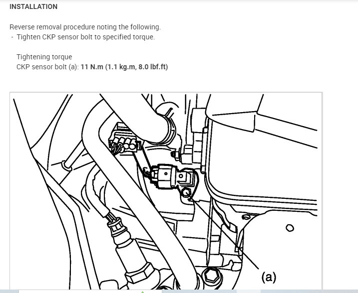

I attached the directions below for the removal and replacement of the sensor. Take a look at them and let me know if you have questions.
Let me know what I can do to help.
joe

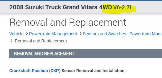

See pics below. Note: This vehicle didn't come with a 2.0L 4-cylinder engine. The directions are for the 2.7L V6 engine.
