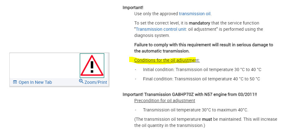

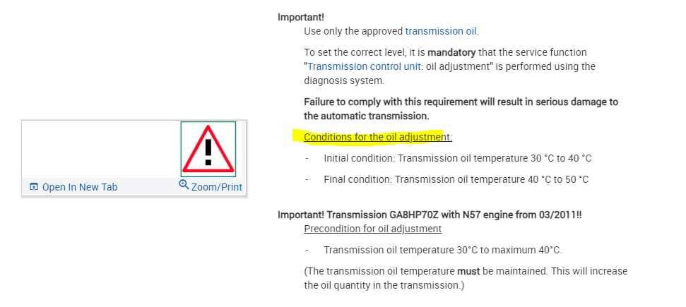

I just need the temperature of fluid to add more fluid after the initial fill, after starting the car. Is it 95c for this car?
Aug 27, 2023 at 10:37 AM
Experienced Mechanic
110,248 POSTS

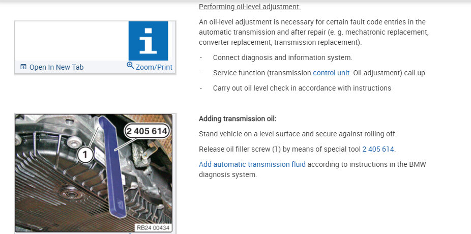

No, that is too hot to check the level. It needs to be between 30C and 40C.

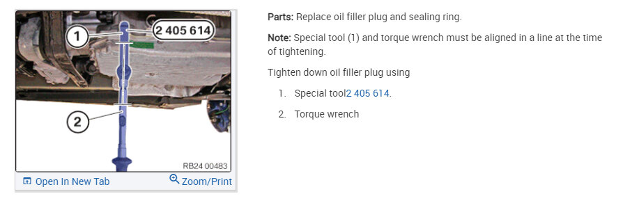

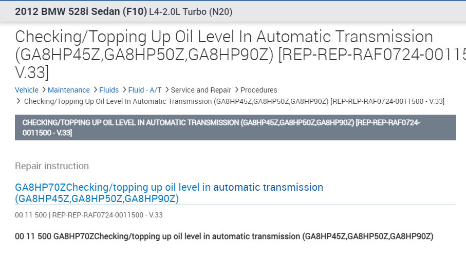

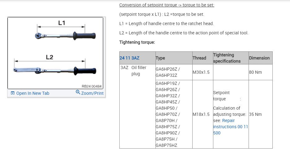

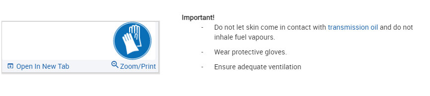

If you look below, I attached the directions for checking and adding fluid. It covers the temperatures.
Take a look through the directions below and let me know if it helps or if you have other questions.
