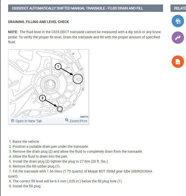

How to change the transmission fluid?
2014 FIAT 500L
189,000 MILES • 4 CYL • 2WD • AUTOMATIC
DIVIDES
  • 903 POSTS
How to go about draining and then adding fresh fluid?
How many quarts needed for drain and fill?
Oct 4, 2021 at 6:10 AM
You have what is called a dual dry clutch transmission which means it is basically a manual transmission that is shifted automatically.
Here is a guide that will help with this type of service, but your vehicle is going to look slightly different:
So, take a look at the info below that is from the manual and that will show the drain and fill plugs. This is going to be closer to doing this on a manual unit rather than an automatic.
Take a look at this info which includes the fluid that you need to use and let us know if you have questions. Thanks
