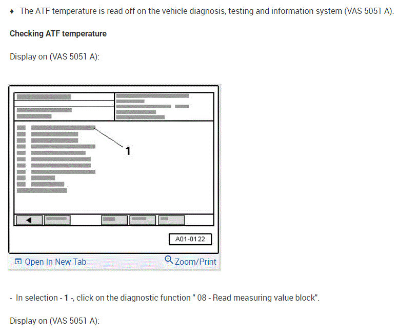

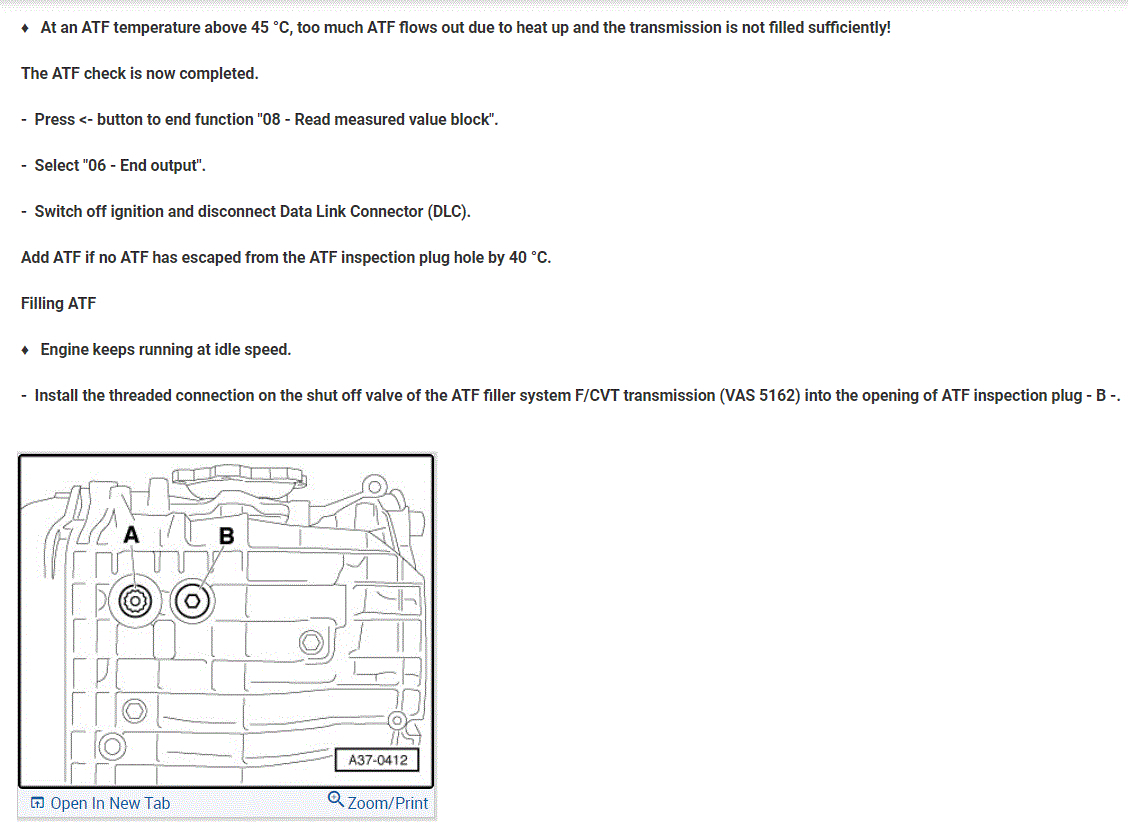

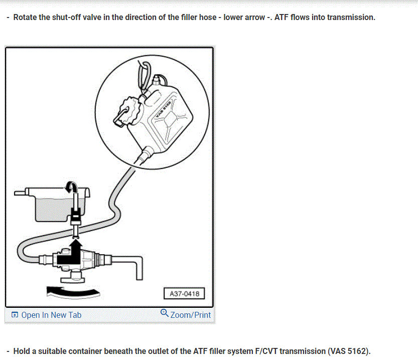

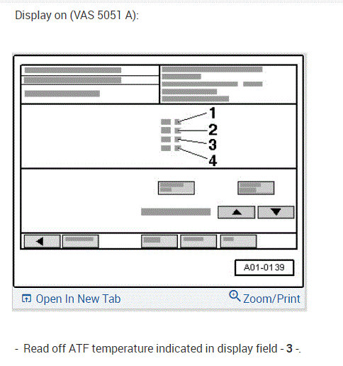

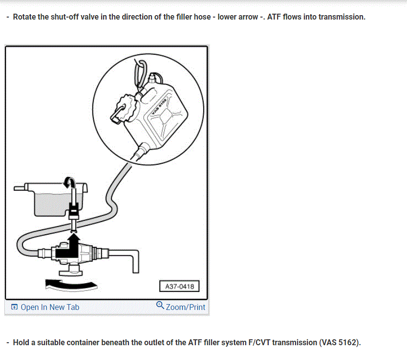

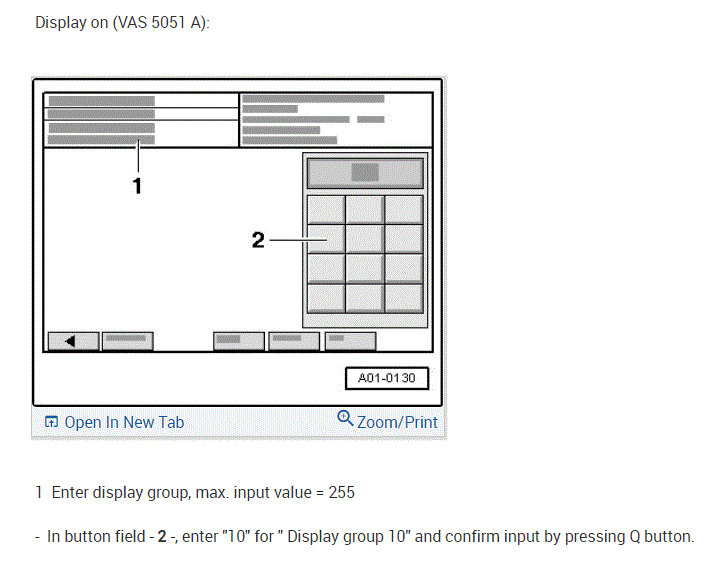

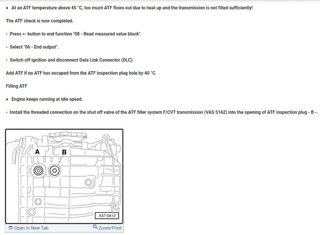

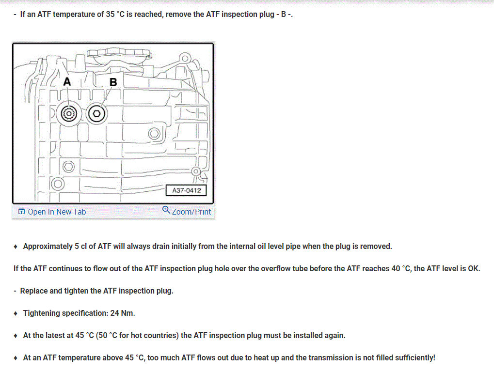

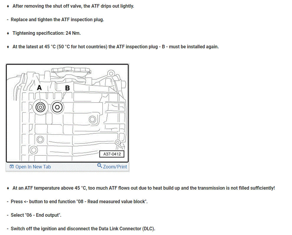

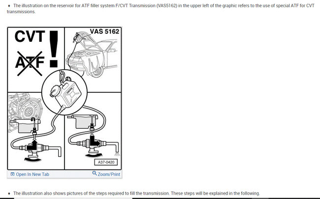

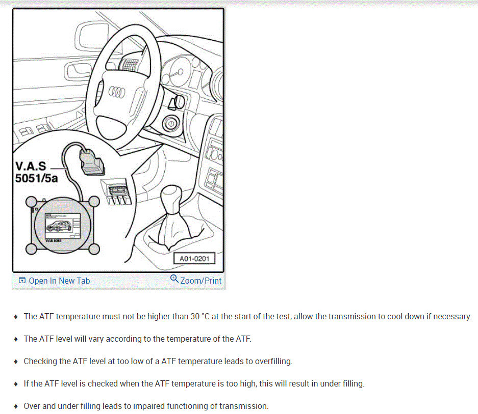

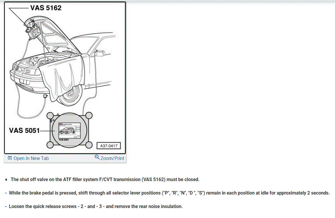

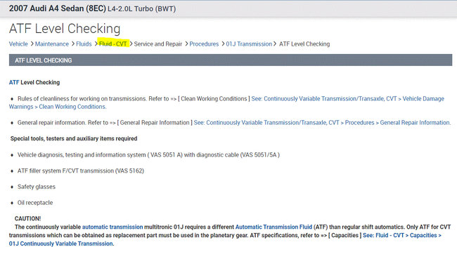

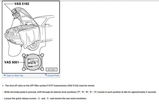

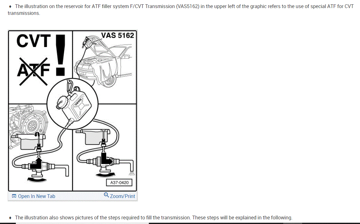

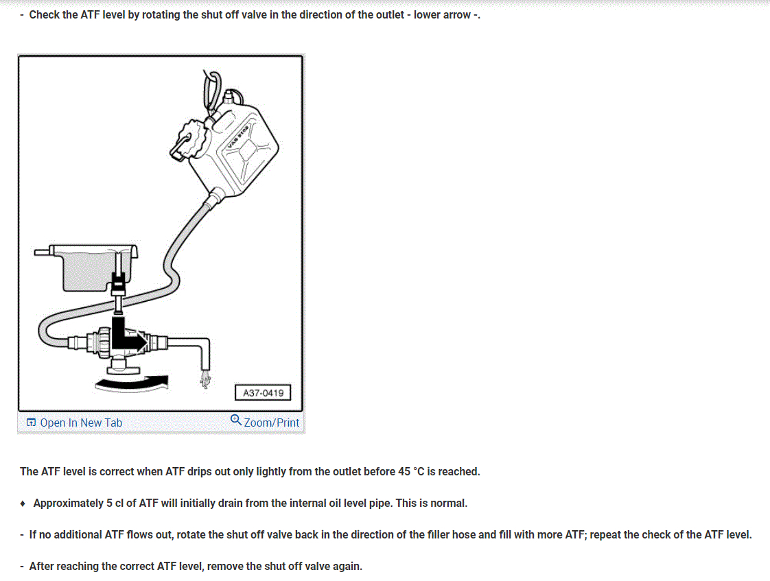

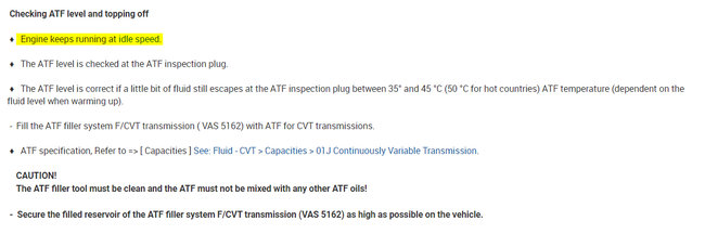

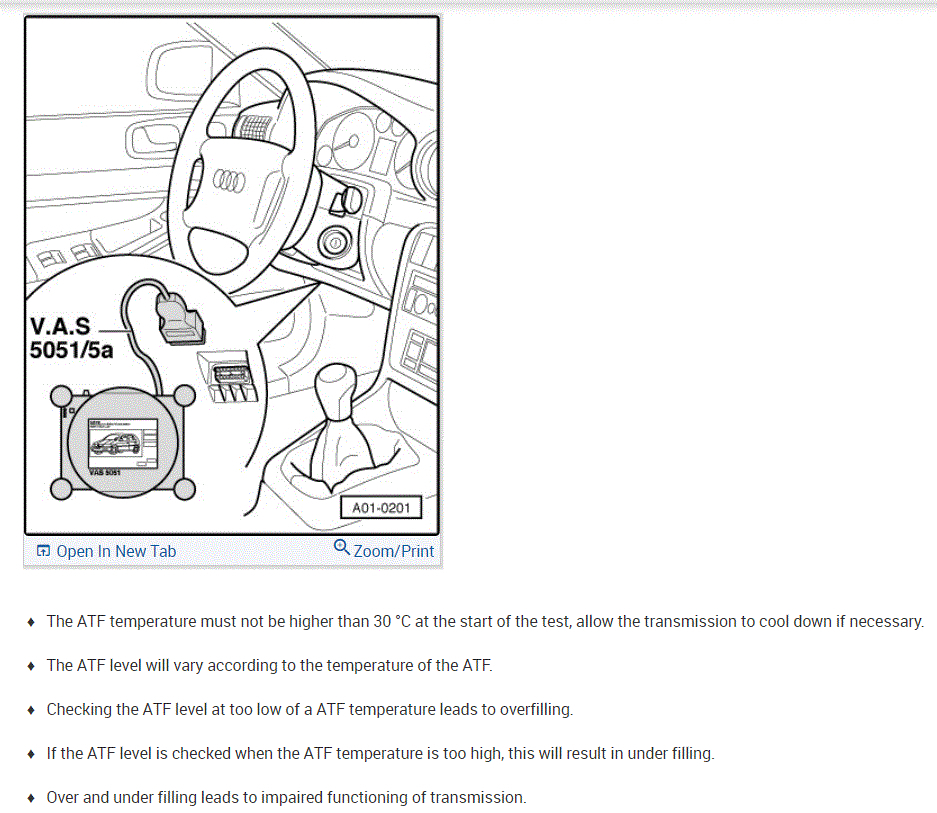

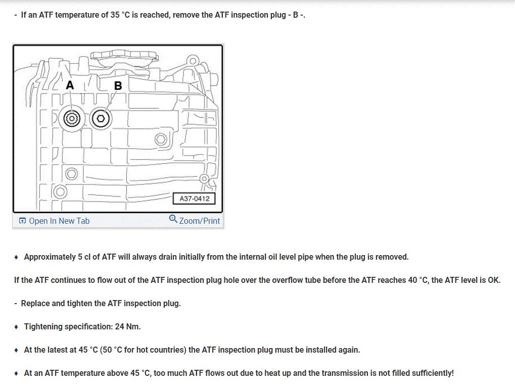

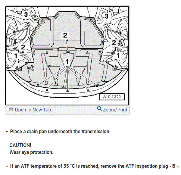

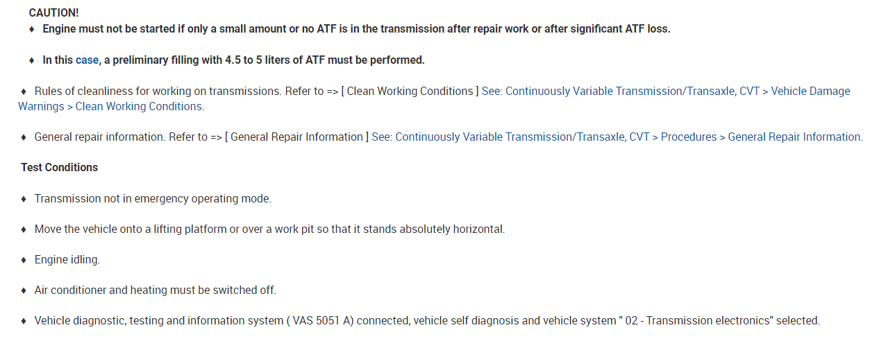

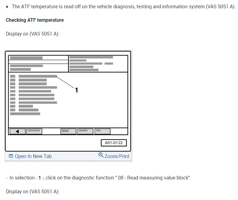

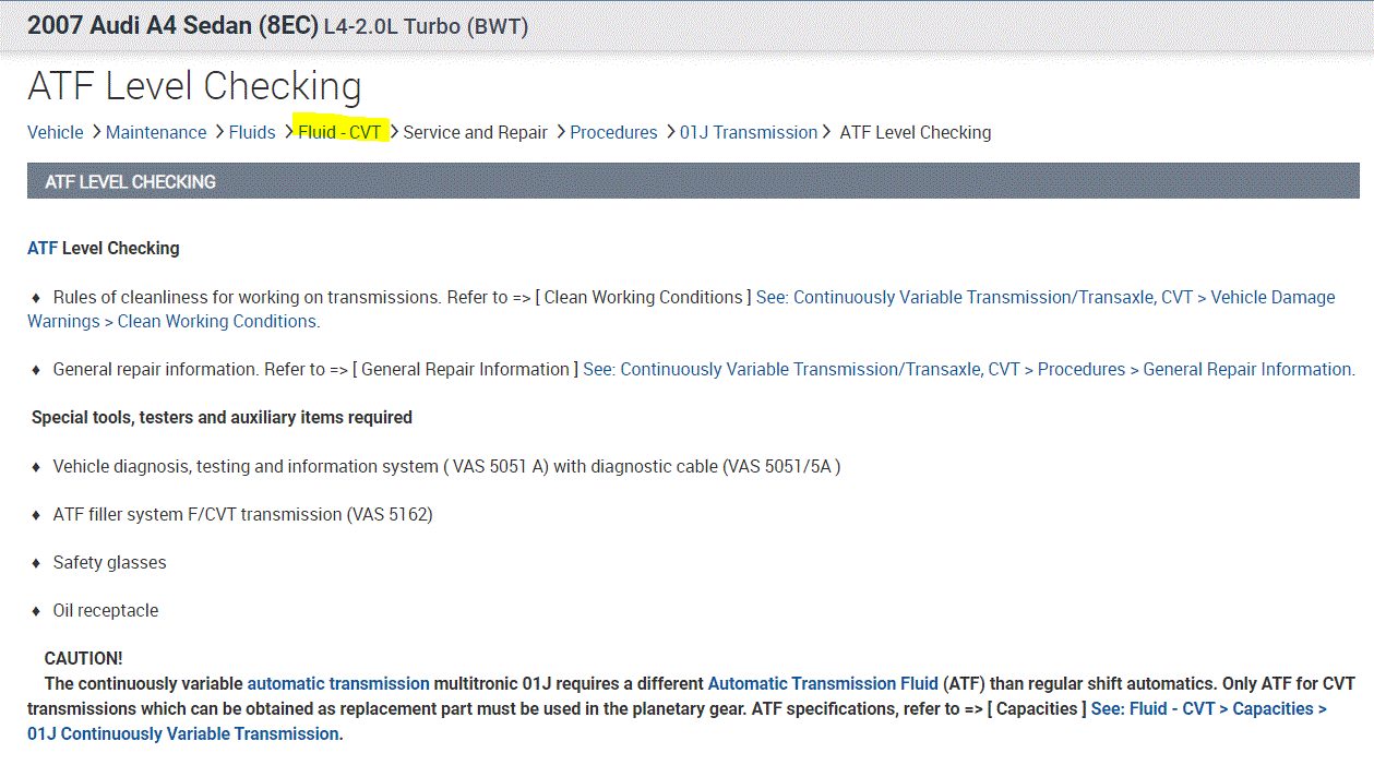

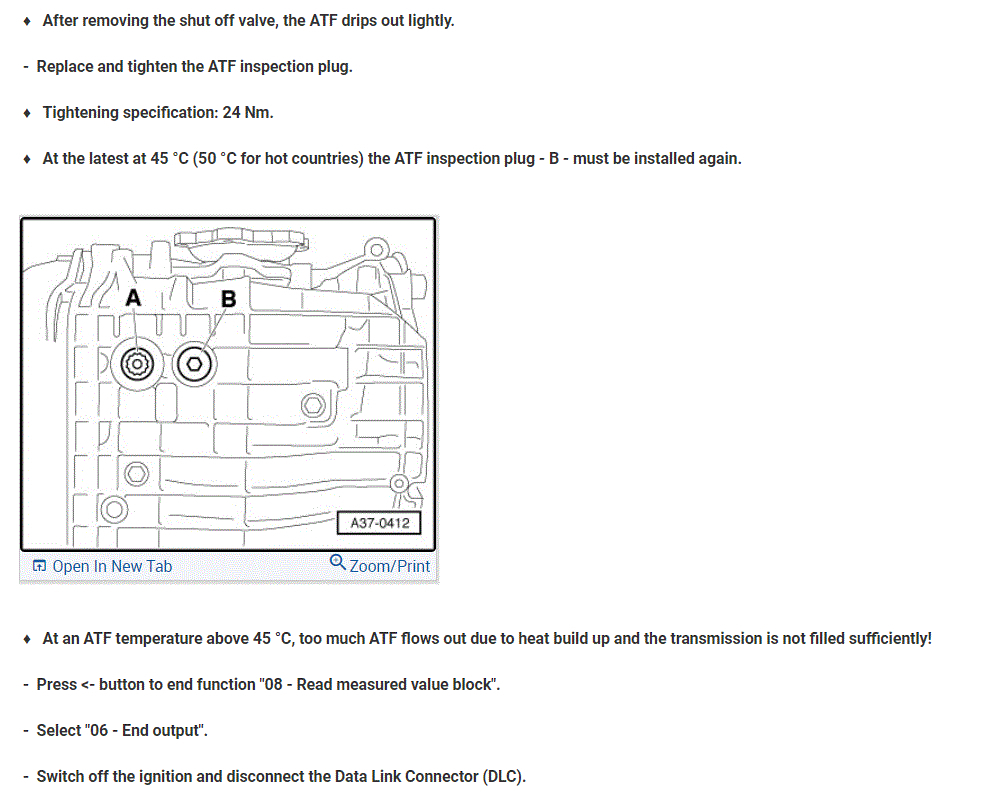

Cvt, after you get the car to 107f do you turn the car off and add or you leave it running? Read conflicting reports online.
Jun 18, 2021 at 3:51 AM
Experienced Mechanic
110,248 POSTS
The engine needs to be running. If you look below, I attached the entire level test procedure specific to this vehicle. I hope it helps.
