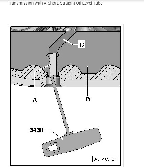

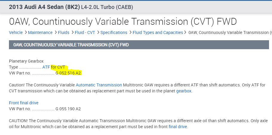

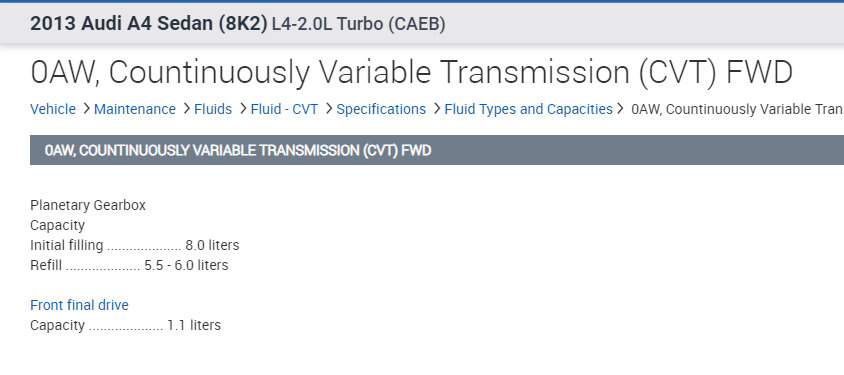

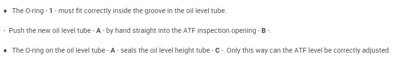

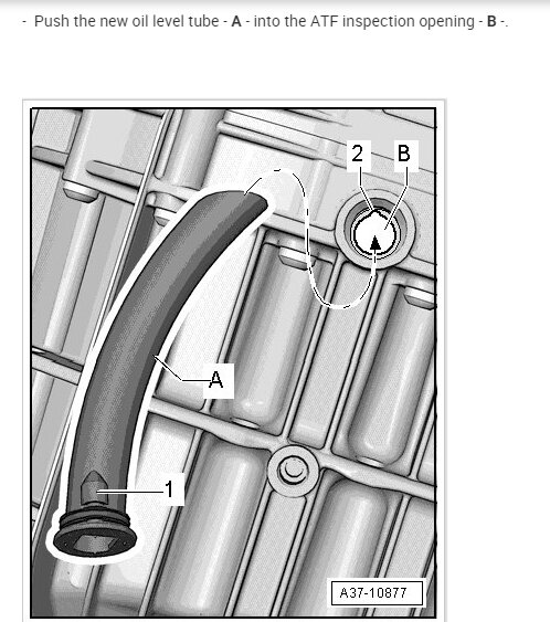

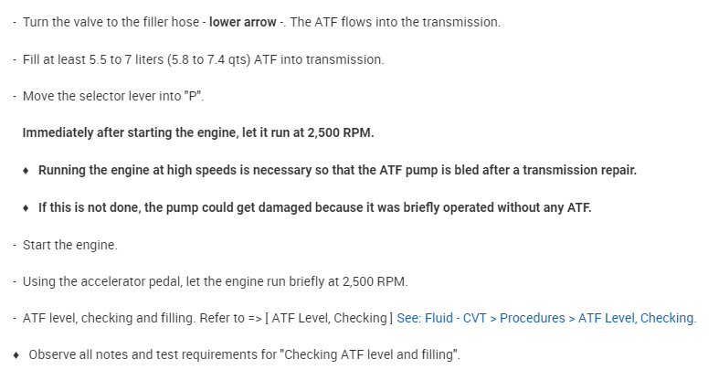

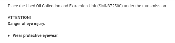

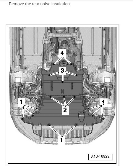

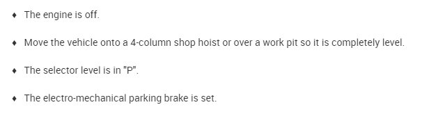

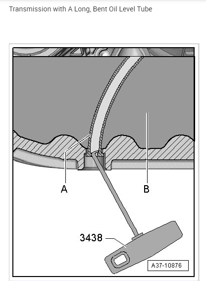

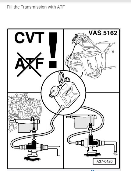

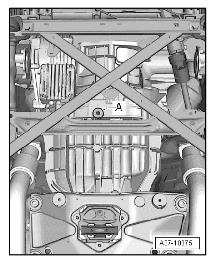

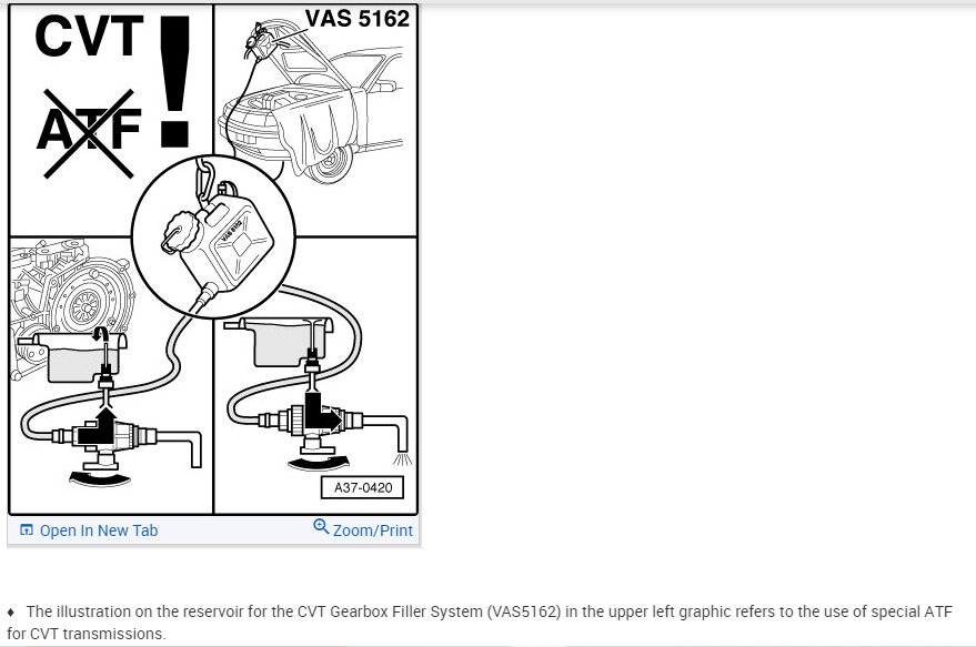

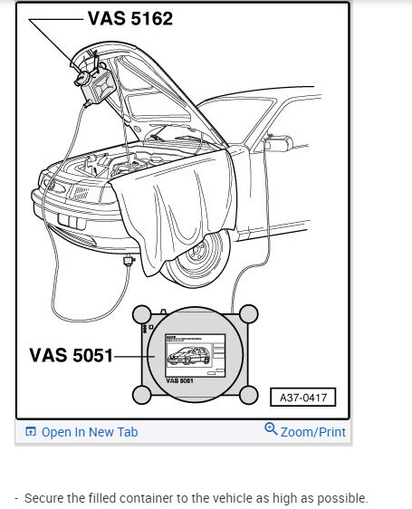

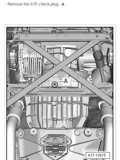

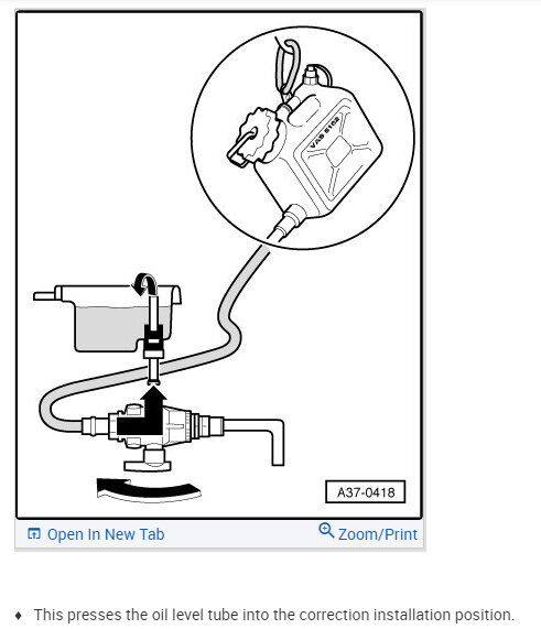

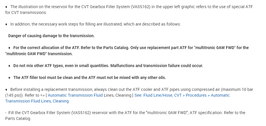

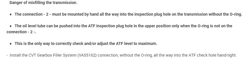

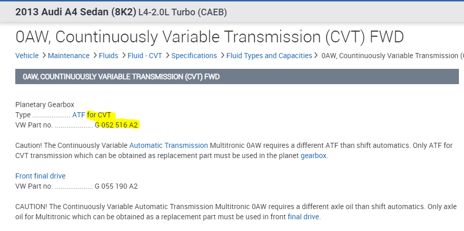

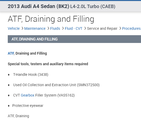

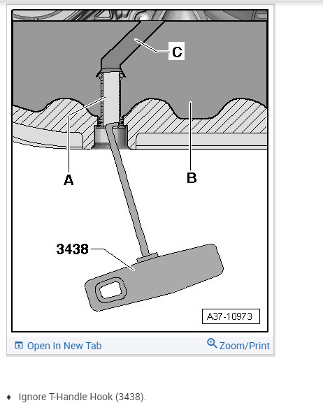

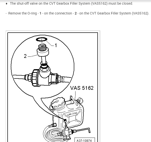

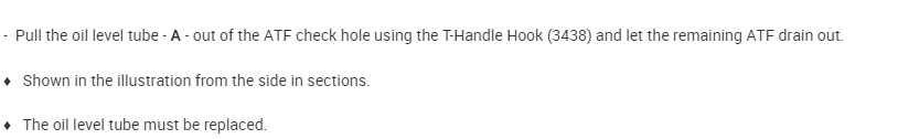

The vehicle listed above is a front wheel drive, 2wd, I need to know the procedure for replacing the CVT fluid and the type and capacity of fluid for a drain/fill. Please
Aug 3, 2023 at 6:31 AM
  • 110,246 POSTS

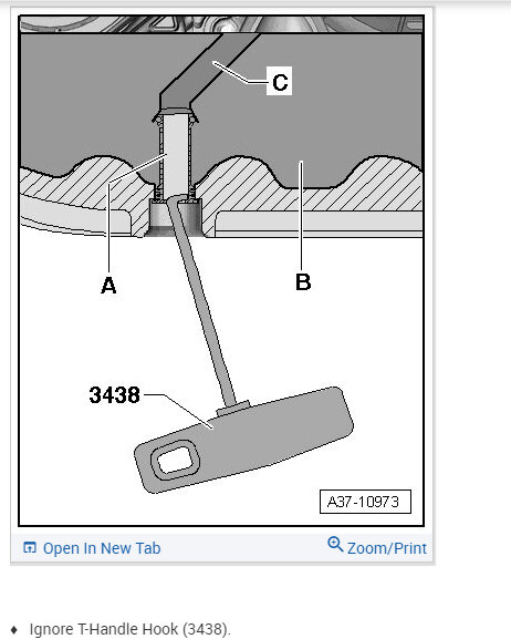

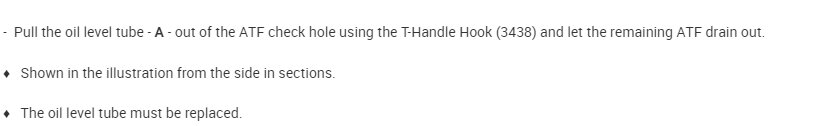

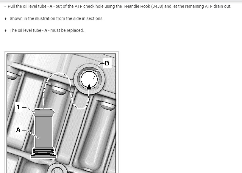

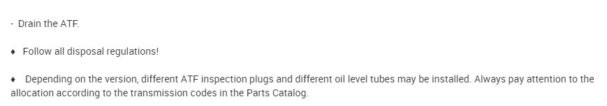

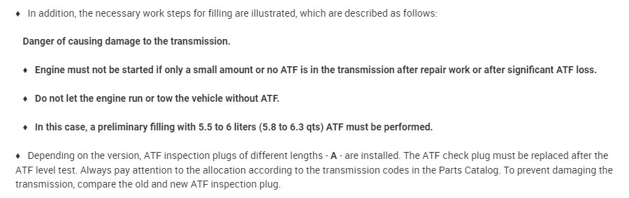

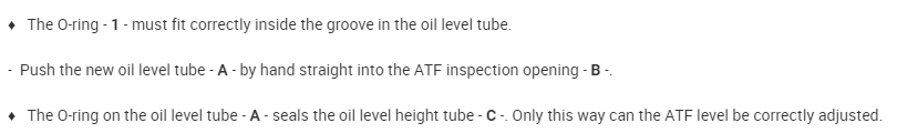

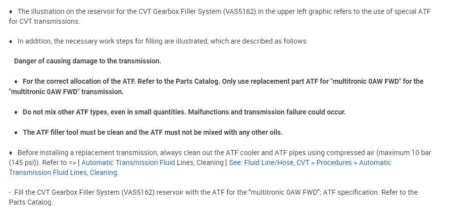

I attached the directions below for draining and refilling the FWD, CVT transmission. Take a look through them and let me know if you have questions.
Also, the last two pics are the fluid specifications and quantities.
Let me know if this helps.
