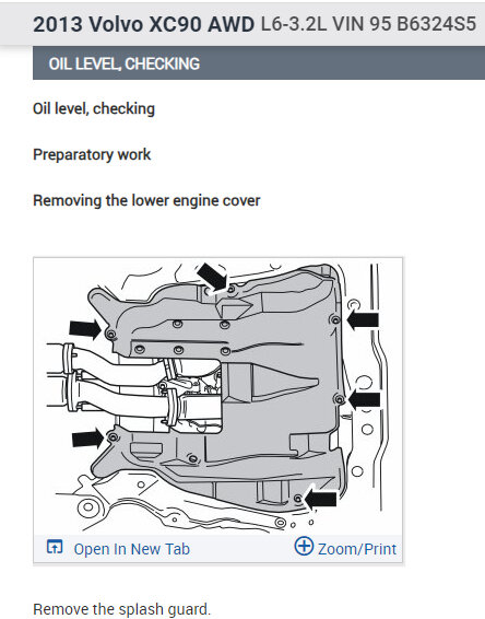

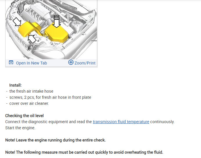

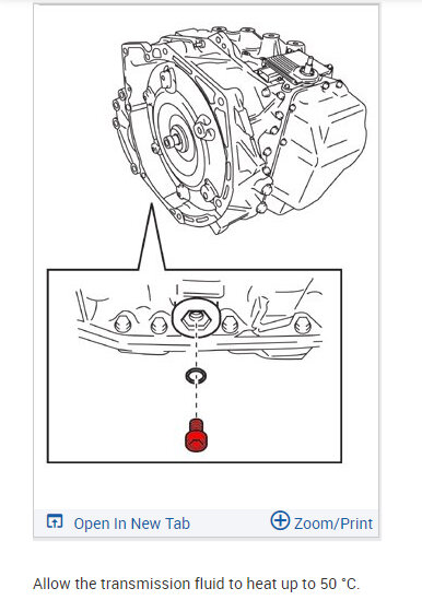

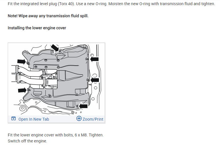

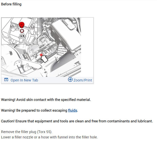

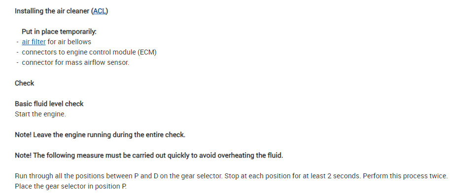

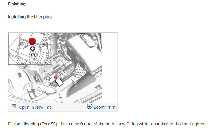

R-design trim. I need to drain and fill the ATF. Can you tell me where the fill plug is? And the type of fluid and capacity recommended for it?
Dec 1, 2023 at 7:31 AM
  • 110,241 POSTS

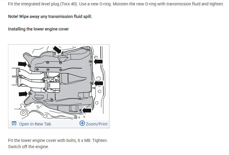

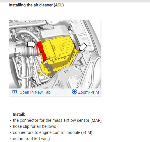

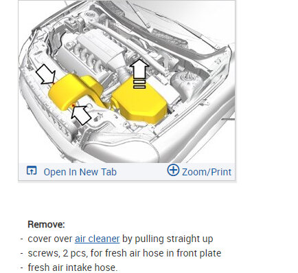

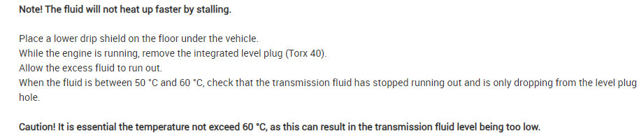

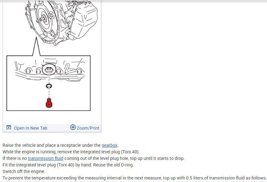

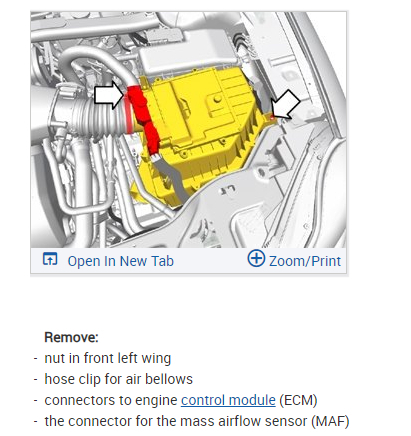

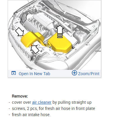

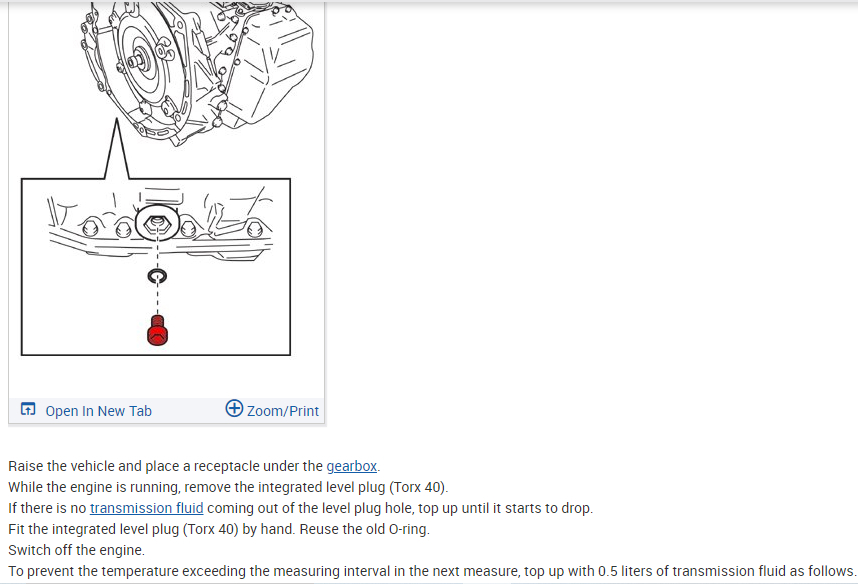

If you are adding transmission fluid, you need to remove the air filter box to access the fill port.
I attached directions below for checking the level. The procedure includes adding fluid and what to remove.
Take a look through them and let me know if this helps.

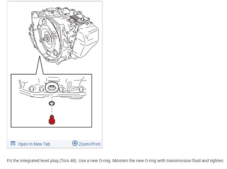

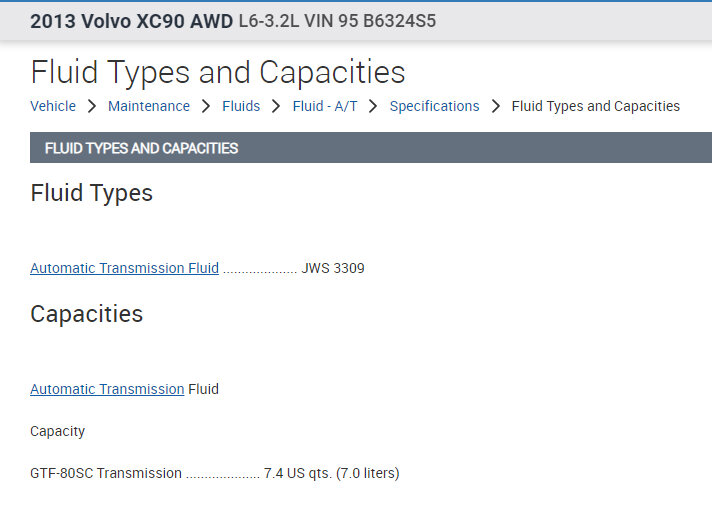

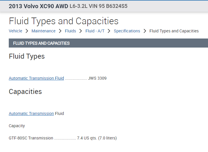

What fluid type to use?
Dec 5, 2023 at 5:24 AM
  • 110,241 POSTS
No problem whatsoever. If you look at the pic below, it includes the fluid type and capacity.
Let me know if this helps.
See pic below.
