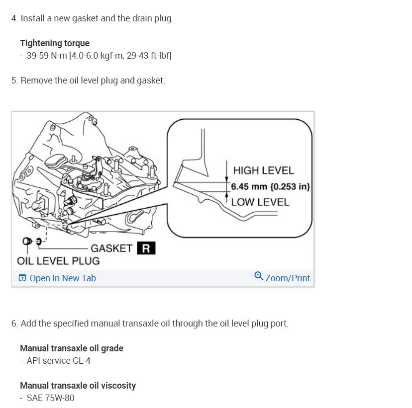

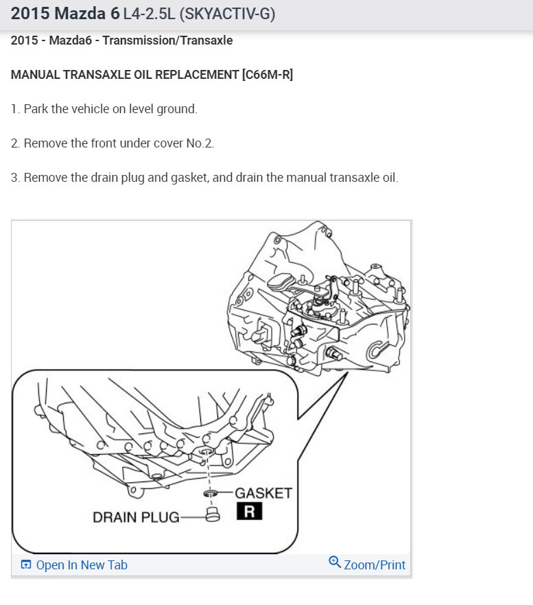

Changing transmission fluid, where is the fill plug and how much does it need for drain and fill and what oil weight?
2015 MAZDA 6
125,000 MILES • 2.5L • 4 CYL • 2WD • MANUAL
BHAMDOC1973
  • 2,007 POSTS
On a 6-speed manual transmission, where is the fill plug and how much does it need for drain and fill and what oil weight?
Jun 5, 2023 at 5:03 PM
  • 54,832 POSTS

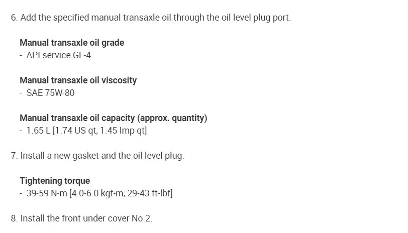

Here is the fluid type as requested:
Fluid Types
Manual Transaxle Oil
Type .................... API Service GL-4
Viscosity .................... SAE 75W-80
Capacities
Capacity .................... 1.74 qt (1.65L)
This video will help walk you through the steps of doing the job and I have included the drain and fill plug location as well in the images below.
https://youtu.be/WqDixYeqslI
Check out the images (below). Please let us know if you need anything else to get the problem fixed.
