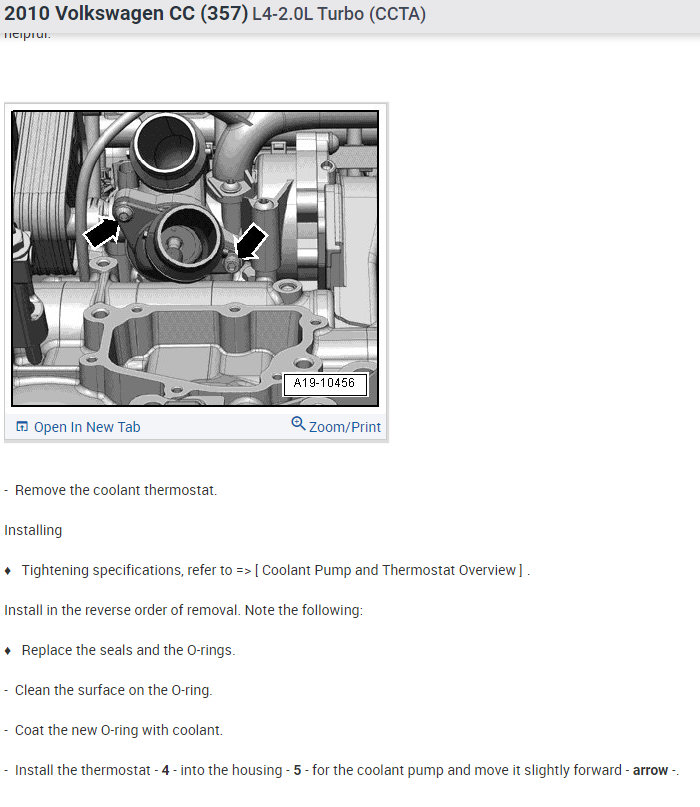

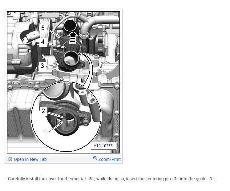

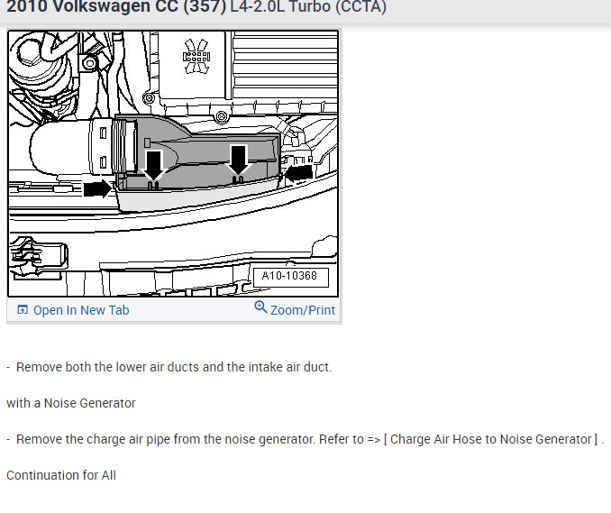

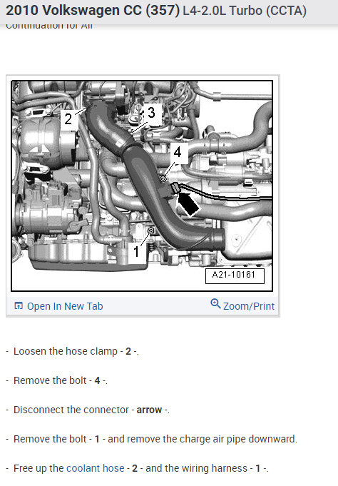

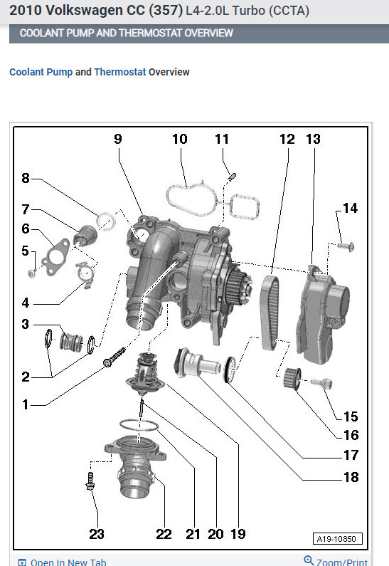

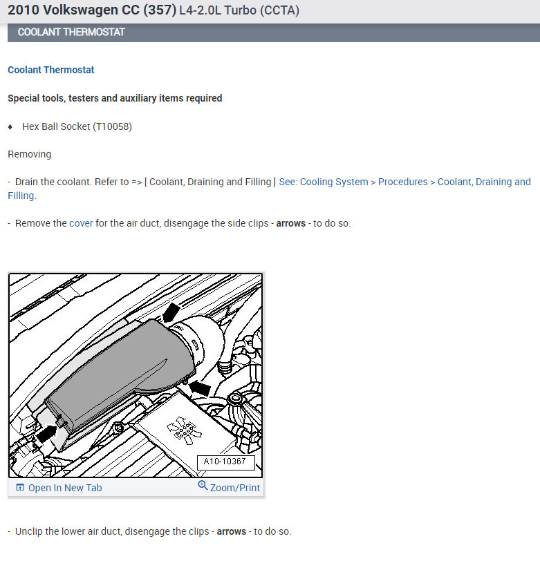

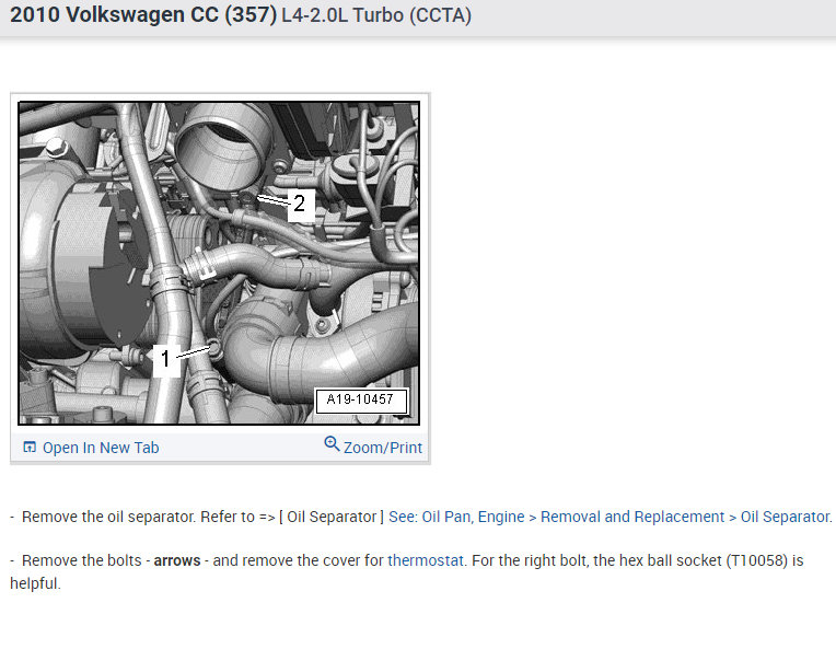

I have the vehicle listed above with a 2.0 turbo and I can't find any videos on how to change my thermostat on it. Can anyone help me?
Sep 27, 2021 at 12:47 AM
SQM
  • 6,383 POSTS

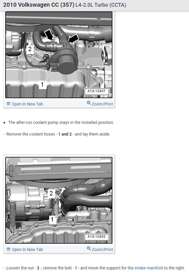

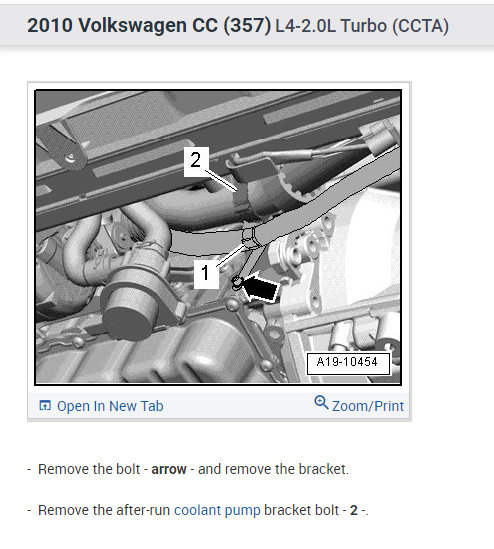

There are few items needs to be removed before you can change the thermostat.
Remember to only work on the cooling system when the engine is cool.
I attached the replacement procedure below.
