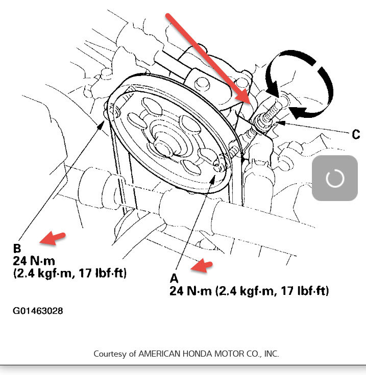

My car has two belts and i only see one tensioner pulley. It wont loosen the belt attached to power steering pump.
Nov 15, 2016 at 11:52 PM
HMAC300
Experienced Mechanic
48,601 POSTS
see picture for adjustment. loosen two bolts then loosen tensioner new belt tension .033"-.045" used belt.051"-.065".
