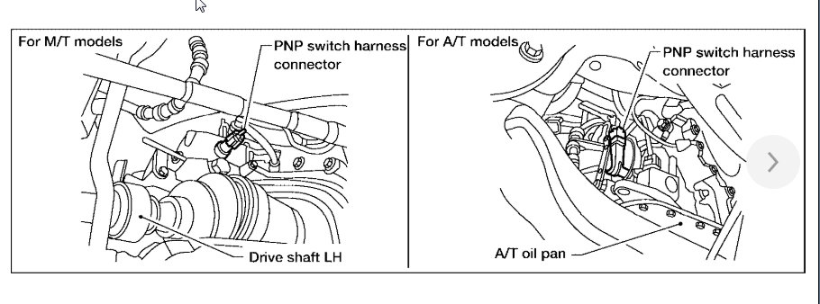

I'm having trouble locating the ignition interrupter switch and need advice on changing it.
Jul 20, 2019 at 3:41 PM
Hi Miguel,
I assume you are referring to the park neutral switch. This is located close to the oil pan on auto transmissions. It is as simple as unplugging it and removing it. Once you locate it, you should not have to remove anything to change it.
Here is a drawing of the location.
