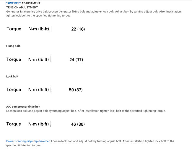

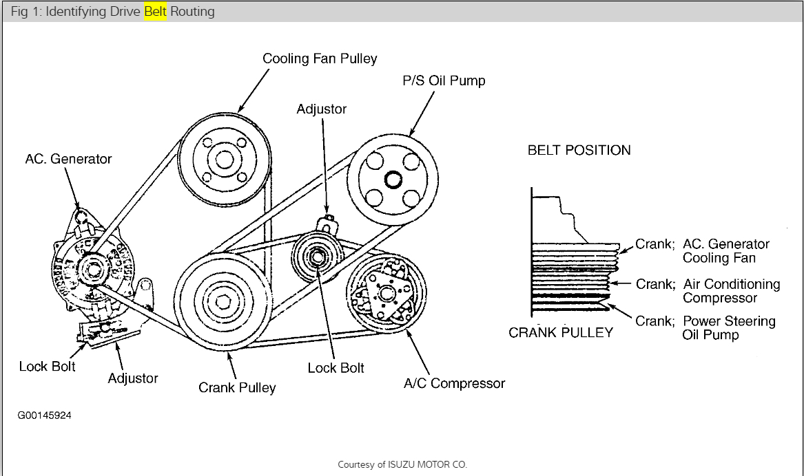

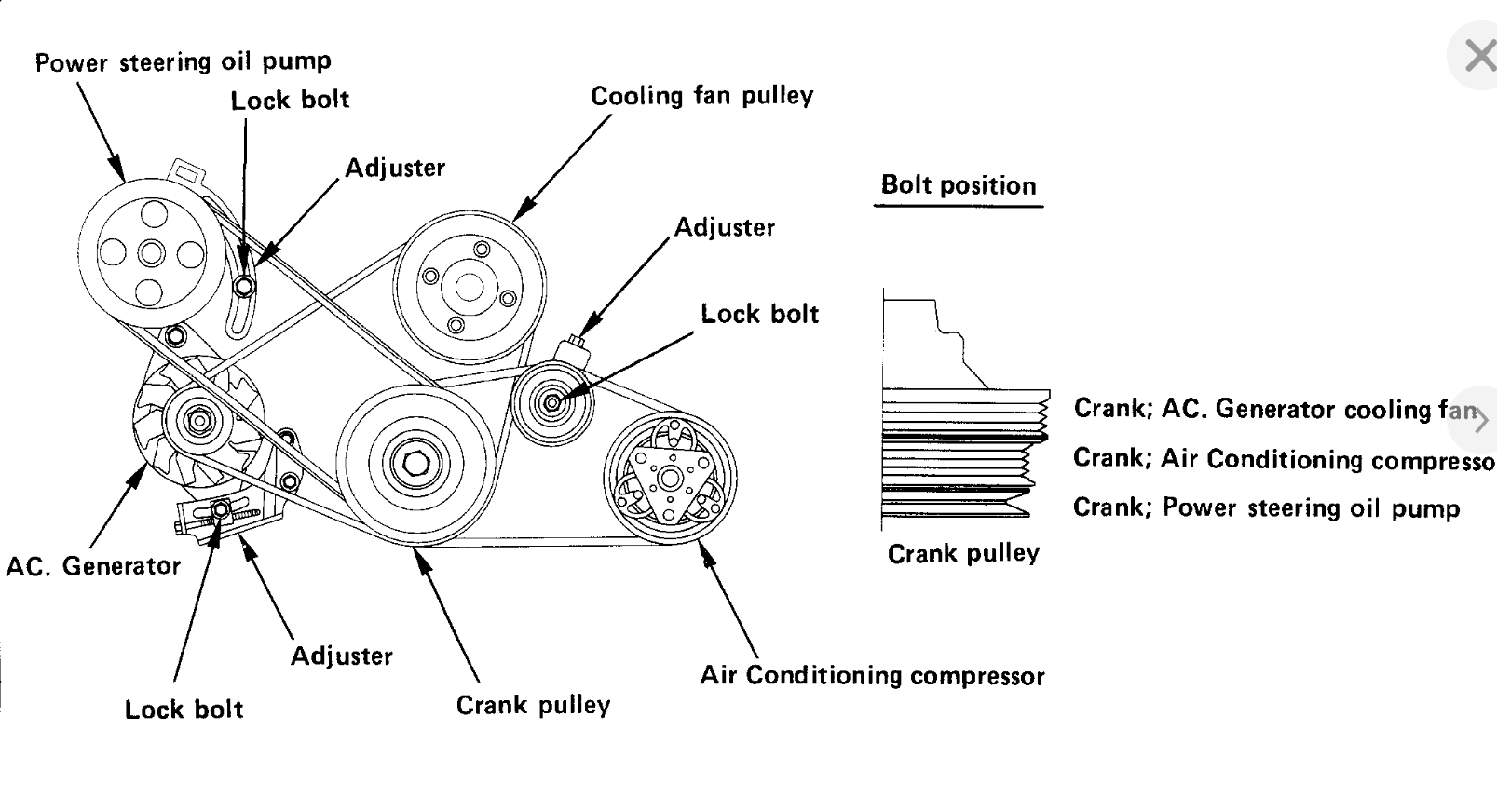

I'm not sure how to change the 3 belts on this vehicle.
May 28, 2022 at 4:16 AM
AL514
  • 5,700 POSTS
Hello, below is the belt routing diagram. There seems to be two different set ups. Can you tell me which one you have on your vehicle? Either way, these are not difficult to change, they just take a little time. I will get you the torque specs for the belt adjuster bolts as well.
