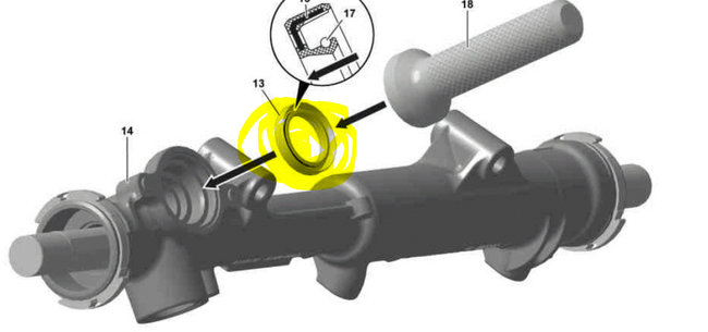

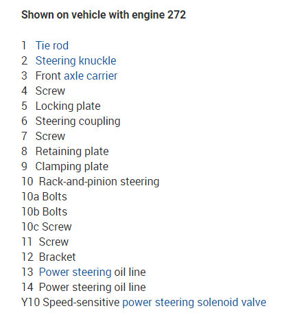

I'm not sure which bushings you are referring to. Are you referring to the radial shaft bushing/seal?
Take a look at the attached pic and let me know if that is what you are referring to.
See pic below.

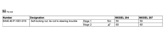

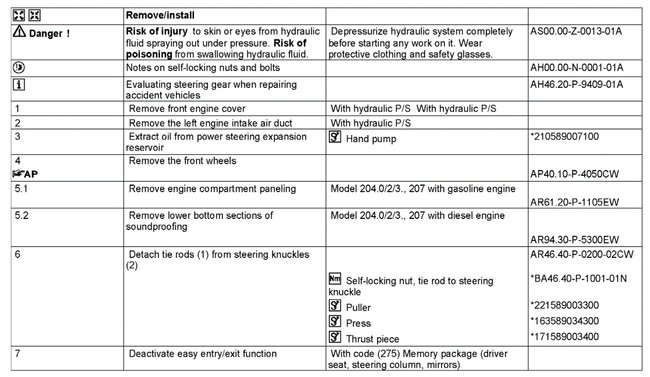

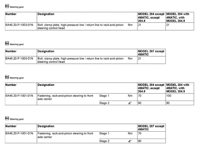

No, the bushing that mounts the rack to the frame.
Sep 10, 2021 at 10:58 PM
  • 110,240 POSTS

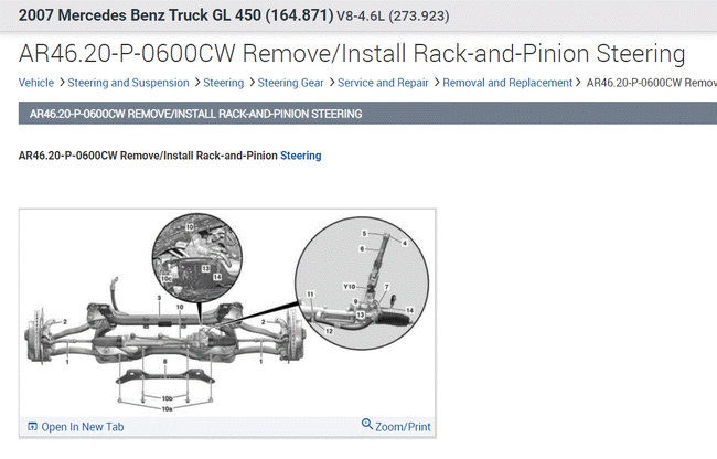

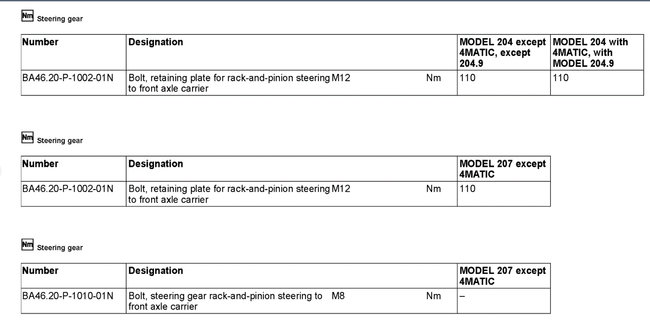

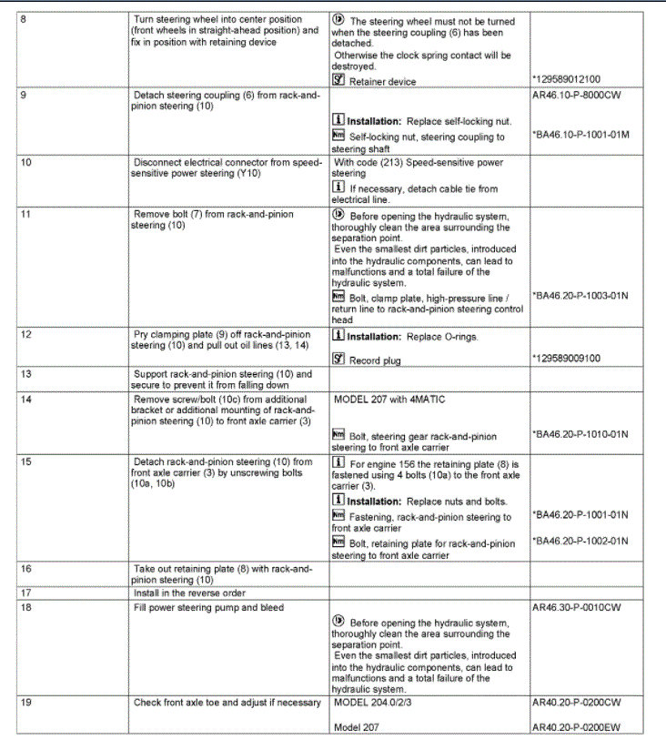

Okay, you are referring to the retaining plates.

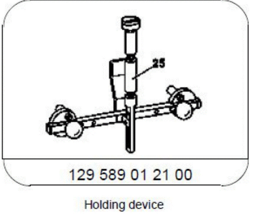

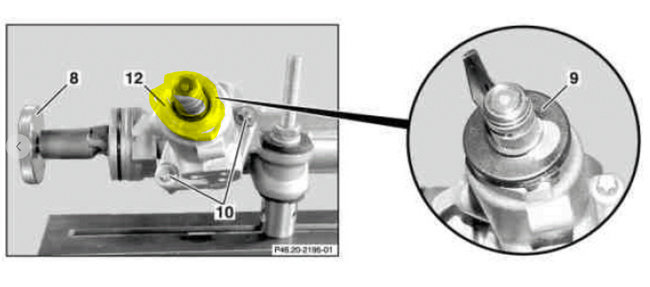

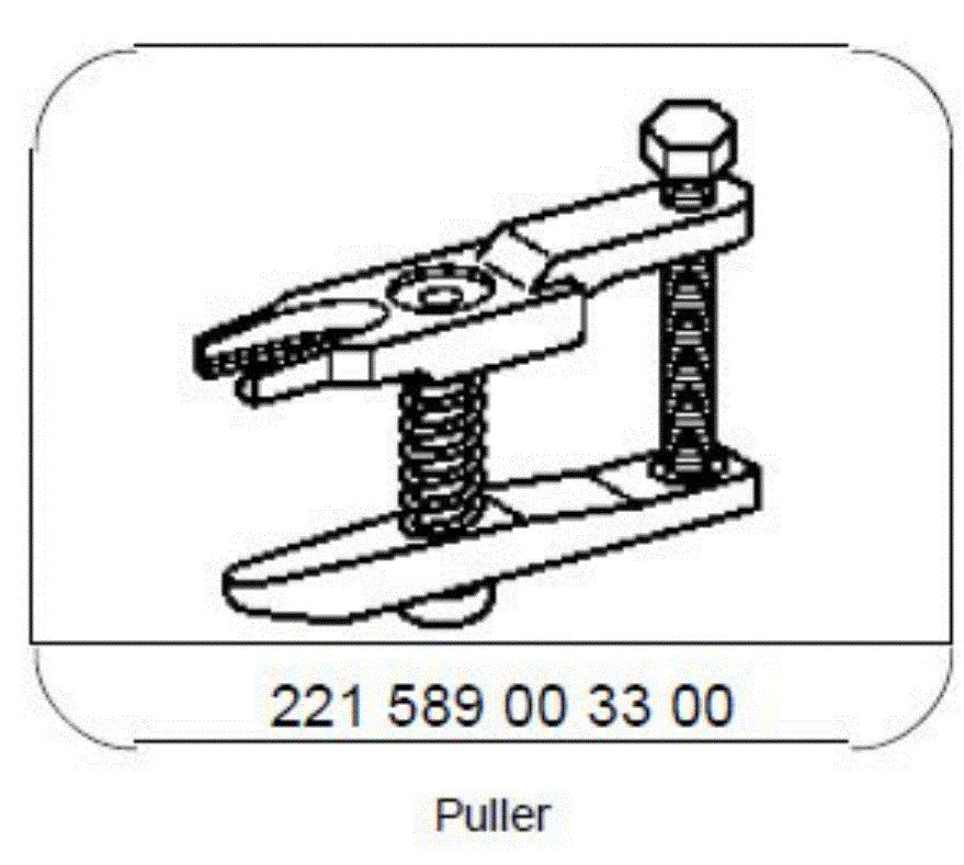

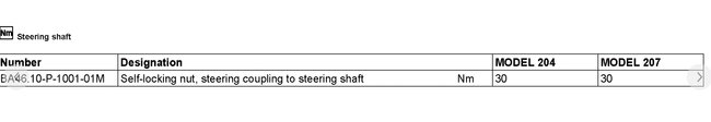

I attached the directions for removal and replacement of the rack and pinion which include removal of the mounts. Take a look through them. You aren't replacing the rack, but the directions include the mounting/retaining plates. Note: This is for the complete removal and replacement of the rack and pinion. You will not need to perform everything.
Let me know if this helps.
