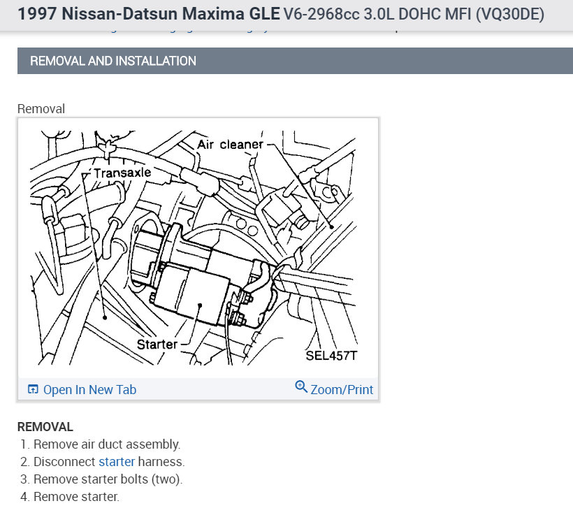

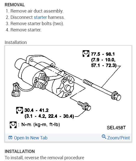

What size wrench takes the starter out?
Oct 2, 2018 at 6:23 AM
  • 55,710 POSTS
The sizes are 14mm for the main bolts, but you must disconnect the battery first. Here is a guide that will work you through the repair and diagrams below to show you how it will be for your car:
