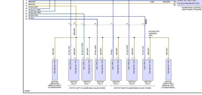

How do you locate and replace spark plugs on my car?

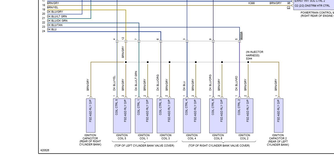

here is a wiring diagram, this will help a bit, As you can see the spark plugs are under each individual ignition coil. This is a direct ignition system (DIS). you will have to unbolt each coil to get to the plugs. it is not as hard as it may seem. Just be easy and do not break anything and you will be fine.
