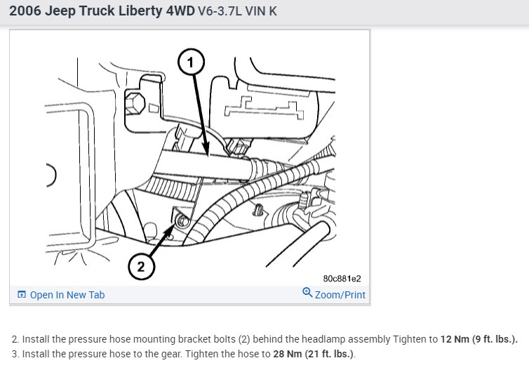

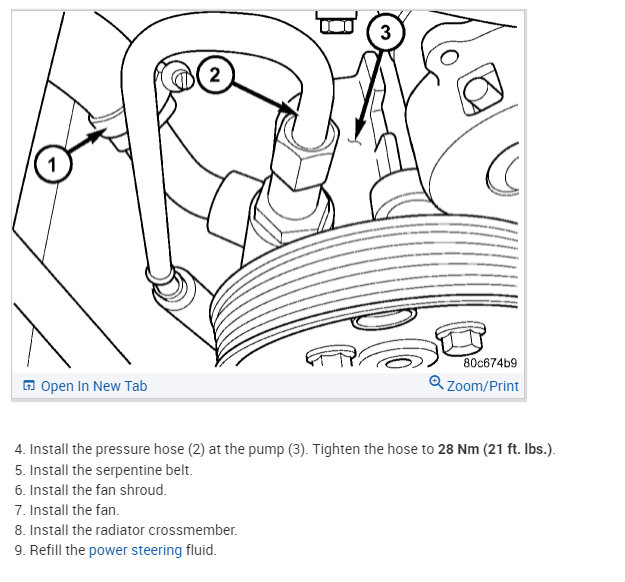

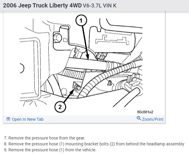

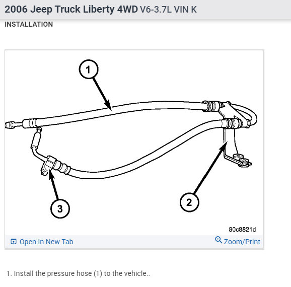

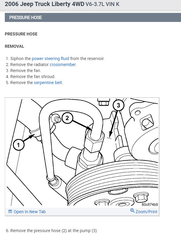

Hi, I want to change my power steering high pressure line myself. The only part I'm not sure about is whether I have to remove the power steering pulley first. It looks like that's the only way I can get to one end of the line. Thanks
Nov 9, 2021 at 6:33 AM
SQM
  • 6,383 POSTS
In order to replace the power steering pressure hose, you will have to remove the radiator crossmember, fan and shroud and the belt.
You might find this video helpful:
https://youtu.be/BGBUv5r9fk0
I have attached the replacement procedure below.
