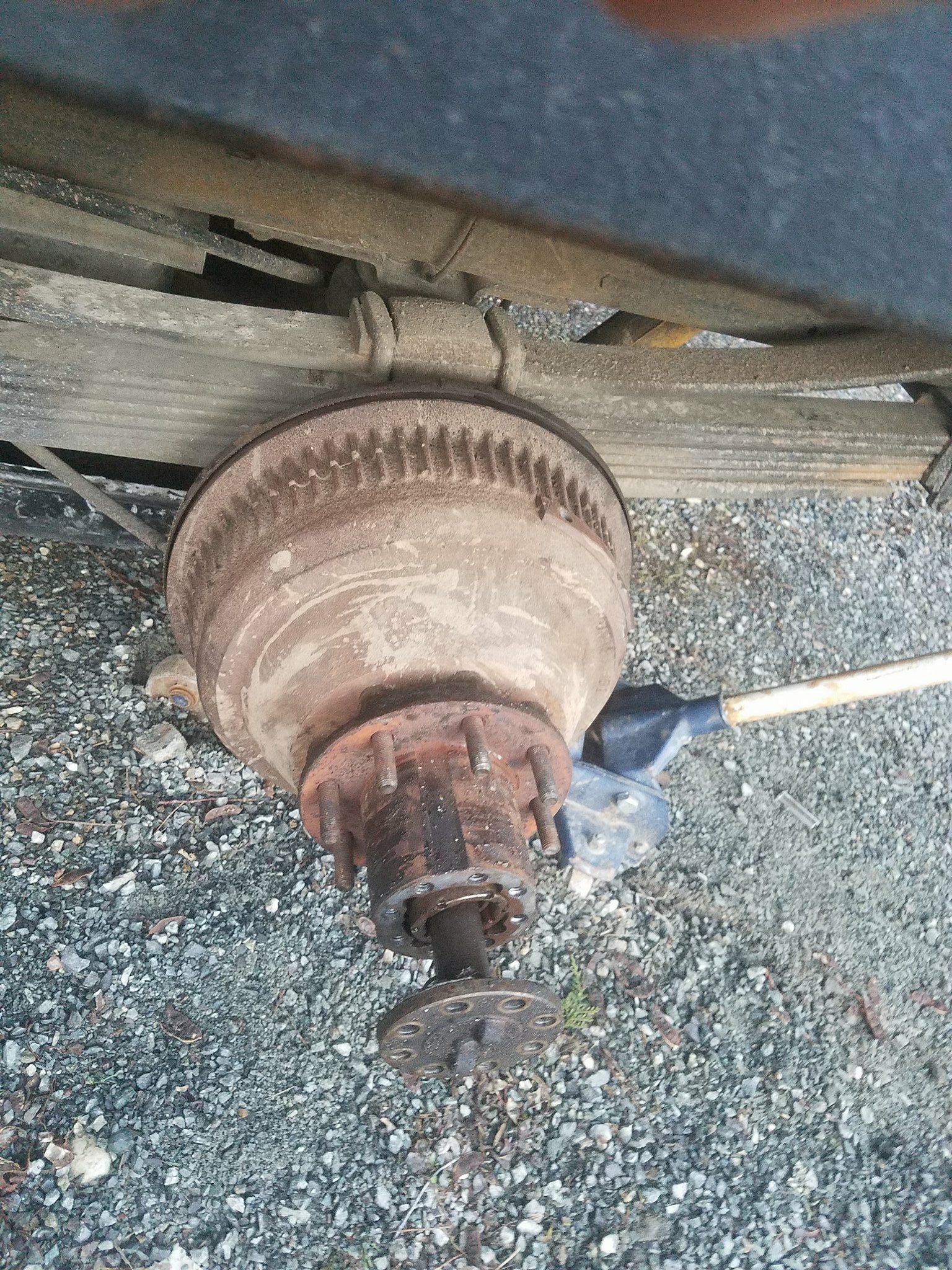

When pulling shaft sticks is there a pin that need to be removed or is there a video for this?

So it is hard to clarify maybe, we do not want to remove the whole axle we are trying to replace the barrings on the left side of the axle and the shaft does not come all the way out.

Can you post a picture of what you have???

Changing out bearings.
Mar 19, 2018 at 12:36 AM
okay, you have a full floating rear axle. after you removed the bolts it should come out.
Is that as far as it will come out? it should slide all the way out.
How did you get off the hub if the axle wont come out?

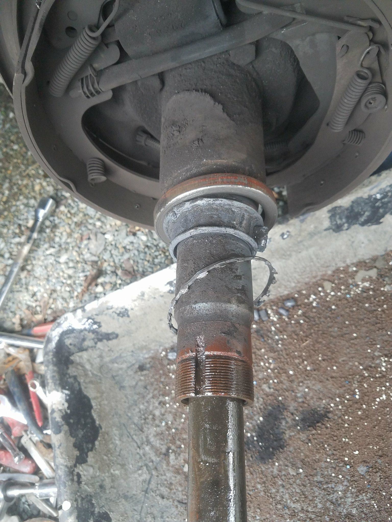

Took out the bolts out but still not coming all the way. It come to what looks like about the end and catches on something. It has grease on it so I do not think it is rusted, but was not sure if there was something missed. I will send a picture later when I pull it all the way out again later.
Mar 19, 2018 at 2:35 AM
Okay, let me know.
