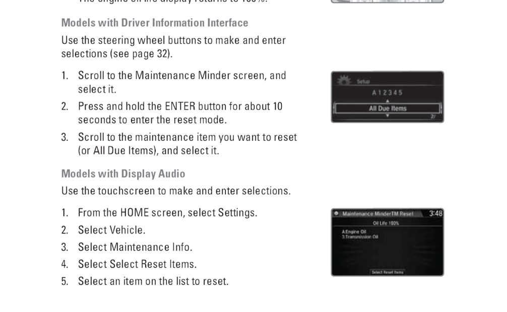

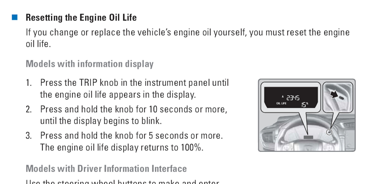

Hello, I was wondering if I change the oil in my CRV how do I reset the computer?

It's not hard. However, there is one of three ways based on equipment. I attached all three below. Let me know if this helps. Note that the first one is the most common, but I don't know exactly which one is relevant for your vehicle.
Take care and let me know if you have other questions.

Thank you I will try that.
