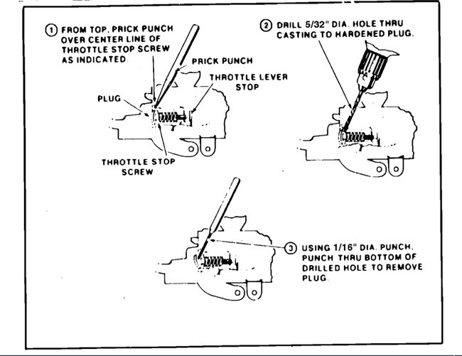

I installed a multi spark ignition and everything was fine for about three months then I noticed that the idle had sped up and it would knock under a load. I figured the timing was too far advanced so I adjusted the timing to 0 degrees at idle. I drove it for about 30 minutes the idle went back up for a little bit and then went back down. next day timed it again and the same thing happened. i remembered to unplug the timing control plug each time I adjusted it.

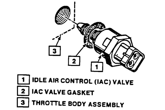

The idle speed is controlled by the idle air control on the throttle body itself.

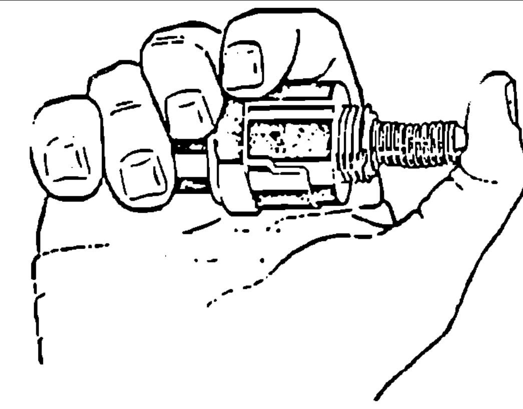

I attached the guide and the some pictures for you of the idle speed control motor.
1987-90 All: Ground diagnostic terminal (see COMPUTER DIAGNOSTIC CODES), turn ignition on but do not start engine. Wait 30 seconds then disconnect the IAC connector. Remove ground from the diagnostic terminal, start engine and turn throttle stop screw to obtain the specified setting speed.

a. The Idle Air Control (IAC) valve is an electrical component and must not be soaked in any liquid cleaner or solvent. Otherwise damage could result.
b. The IAC valve for this application is thread-mounted and has a dual taper, 10 mm diameter, pintle. Any replacement of the IAC valve must have the correct part number, with the appropriate pintle taper and diameter for proper seating of the valve in the throttle body.
REMOVAL:
1. Disconnect electrical connector.
2. Remove IAC valve, use a 32 mm (1 1/4") wrench.
3. Remove IAC gasket and discard.
4. Clean old gasket material from surface of throttle body assembly to insure seal of new gasket.
Idle Air Control Valve Pintle Retraction (Manually)
NOTES:
a. If the IAC valve was removed during service, its operation may be tested electrically with the IAC/ISC Motor Tester (J-37027 or BT-8256K) or equivalent. Before installing a IAC valve, measure the distance between the tip of the valve pintle and the mounting surface. If the dimension is greater than 28.0 mm (1.10 inches), the valve pintle must be retracted to prevent damage to the valve. This may be done electrically using an IAC/ISC Motor Tester or manually by exerting firm pressure, as shown in the illustration, with a slight side to side movement on valve pintle to retract it.
b. No physical adjustment of the IAC valve assembly is required after installation. The IAC valve pintle is reset by turning the ignition ON for ten seconds and then OFF. The ECM then resets the pintle to the correct position. Proper idle regulation should result.
INSTALLATION:
1. Install the IAC valve into the throttle body with new gasket.
NOTE: New IAC valves have been reset at the factory and should be installed in the throttle body in an "as is" condition, without any adjustment.
2. Tighten IAC valve assembly to 18.0 Nm (13.0 lb-ft).
3. Reconnect electrical connector to IAC valve.
