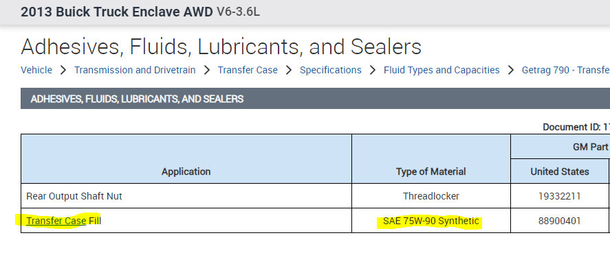

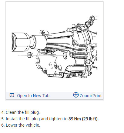

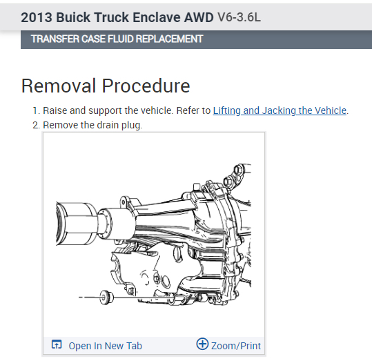

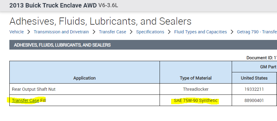

Changing front transfer case fluid, how to do this and what is the capacity and what type of fluid?
2013 BUICK ENCLAVE
164,000 MILES • V6 • 4WD • AUTOMATIC
BHAMDOC1973
  • 2,007 POSTS

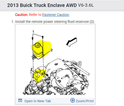

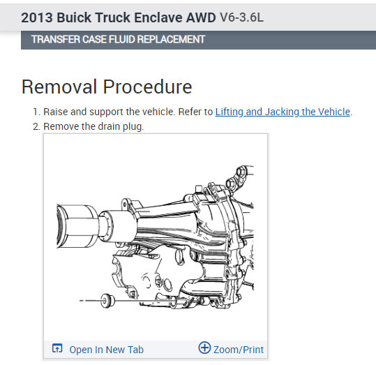

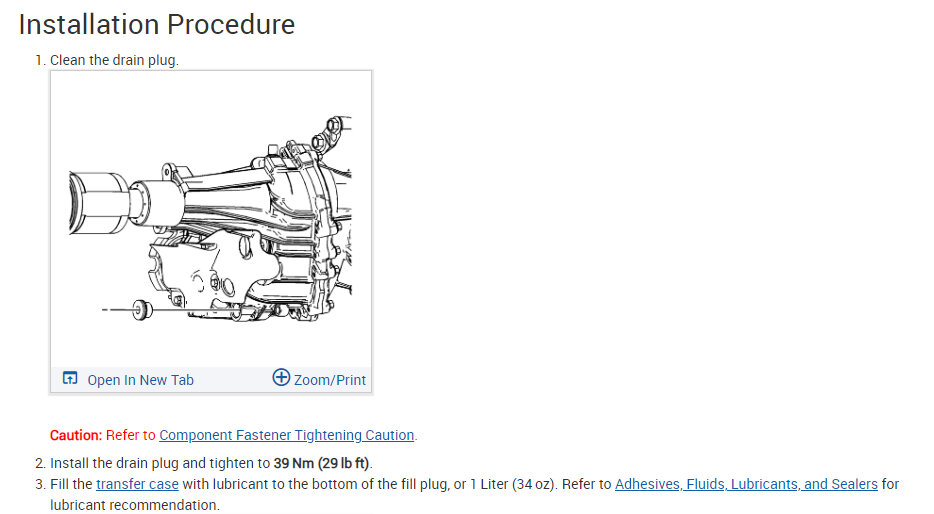

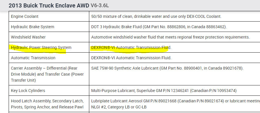

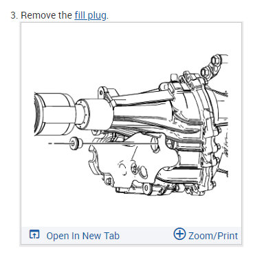

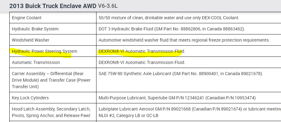

I am hearing a bit of whining while turning, but this car has no power steering fluid i guess its electric, am thinking it's the front transfer case attached to the transmission, i want to change the fluid. How and what is the capacity and what type of fluid? Please
Jan 5, 2024 at 12:05 AM
  • 110,241 POSTS
When you hear the noise while turning, does it stop when you release the steering wheel? I ask because normally, a transfer case won't produce a whining noise. Low power steering fluid will. There should be a P/S fluid reservoir. See pic 6 below.
As far as the transfer case, I attached the directions below. Pic 5 shows the fluid type needed.

I may have missed the power steering reservoir. I will check again, thanks. The noise goes away once the steering is straight yes.
Jan 5, 2024 at 10:07 PM
  • 110,241 POSTS
That sounds like the pump is low on fluid or starting to go bad. Let me know what you find. I'm interested in knowing.
